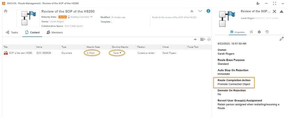

Case 1
When you set up the “Route Completion Action” as “Promote Connected Objects” and “Blocking Maturity” state as of the content as “None”:
  1. The Maturity State of the content of the route can be changed before route’s completion.
  2. When the route is completed, the content’s Maturity State is NOT automatically promoted to the next state.
Use: With this, out of all the content added in the Route, you can set up Blocking Maturity as “None” for the content that you would not like to promote automatically to next state after route’s completion.

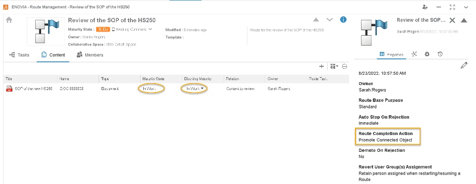

Case 2.1
When you set up the “Route Completion Action” as “Promote Connected Objects” and “Blocking Maturity” state as of the content as “Current State”:
  1. The Maturity State promotion of its content is blocked until the route is completed.
  2. When the route is completed, the content’s Maturity State is automatically promoted to the next state.
Note: The Current State in this example means that the Blocking Maturity state of the content is same as its Maturity State while adding it in the route content.

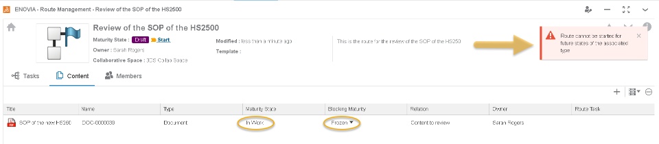

Case 2.2
When you set up the “Route Completion Action” as “Promote Connected Objects” and “Blocking Maturity” state as of the content as “Future State”:
  1. Route’s Maturity State cannot be promoted to the “To Do” until the Maturity State of the object is same as Blocking Maturity state of the object.

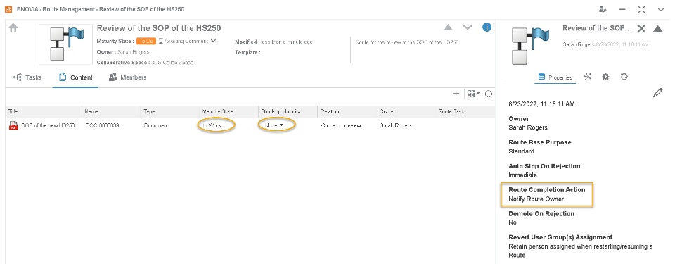

  2. The Maturity State promotion of its content is blocked beyond the “Blocking Maturity” state until the route is completed. In this case, you can promote the document in above image from In Work > Frozen state but not beyond it until the route is completed.
  3. When the route is completed, the content’s Maturity State is automatically promoted to the next state. In this case, the document in above image will be automatically promoted from Frozen > Released state after route completion.
Note: The Future State in this example means that the Blocking Maturity state of the content is set as one of the next Maturity State of the content. For example, Maturity State of the document = In Work; Blocking Maturity of the document = Frozen.

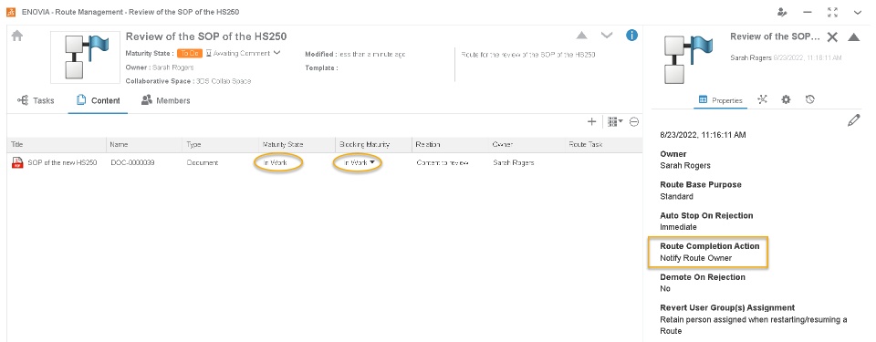

Case 4
When you set up “Route Completion Action” as “Notify Route Owner” and “Blocking Maturity” state of the content as “Current State”:
  2. After completion of route:
  • The Maturity State of the content is not automatically promoted.
  • When all tasks are completed, route owner receives a notification.

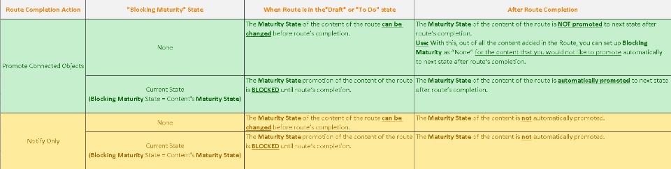

TL;DR? Here's a Summary for you:
