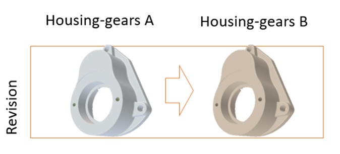

Revision
To describe the object evolution in a specific “branch”.
This evolution is described through the lifecycle of the revision.
Example:
New revisions are created from a production revision B:
Revision B (of Product 1) à for Production
Revision C (of Product 1) à for production
Revision D (of Product 1) à for production

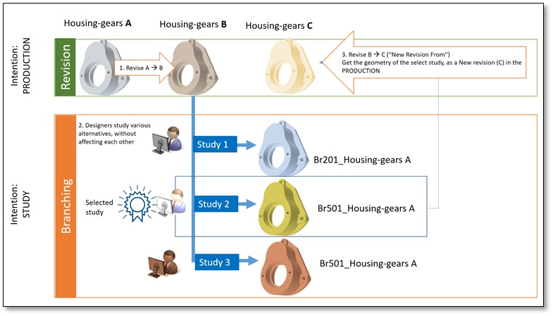

Let’s look at this example to better understand the process of branching:

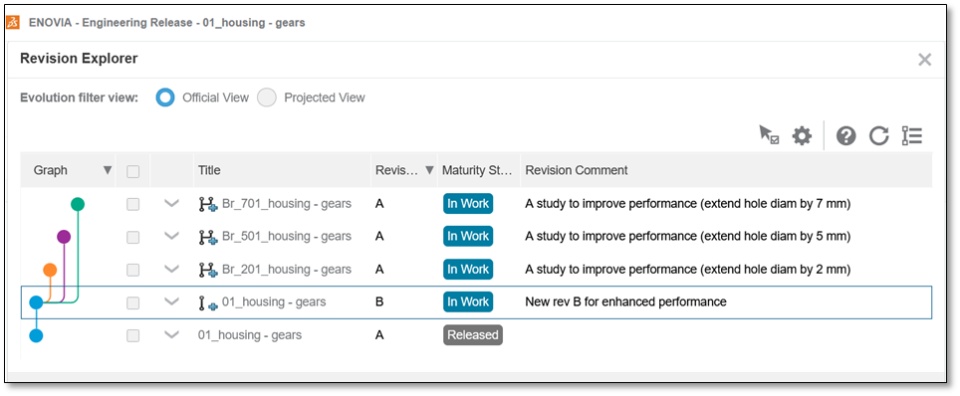

A problem has been raised on a production housing-gear part. The design project manager is asking different designers to provide new studies and to select one that is best for production.
Two revisions of this part exist: A, B (both are in the ‘production’ phase).
As decided by the project manager, the designers need to work on a study based on revision B:
Three different designers will do a study in parallel, without affecting each other. At the end of the study process, the best revision that fits the requirements will be selected to be merged in a new production revision C.
The project manager prepares the work for the designers by creating three branches from revision B:
Br_701_housing-gears
Br_501_housing-gears
Br_201_housing-gears
(All these branches are linked to the revision B of the 01_housing-gears).

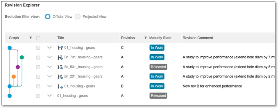

The branch Br_501_housing-gears has been studied and selected as the best one to achieve the target.

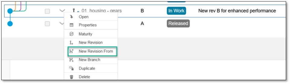

In order to apply the content of this branch to a new revision (C) of the Production branch (revision B), we can “merge” this branch into a new revision. This is done in a single command “New Revision From”:
When you select the option “New Revision From”, the following dialog box is displayed showing the current “Source Structure”:

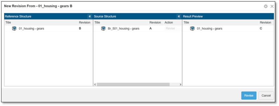

Upon selection of the Br_501_housing-gears branch, the dialog box is expanded with more information (“Reference Structure” and “Result Preview”):
  • Reference Structure:
The original revision that is being revised (01_housing-gears Revision B)
  • Source Structure:
The revision (branch) that its content (Br_501_housing-gears Revision A) will be merged into the newly created revision (C).
  • Result Preview:
The newly created revision C (which is a revise of 01_housing-gears revision B)

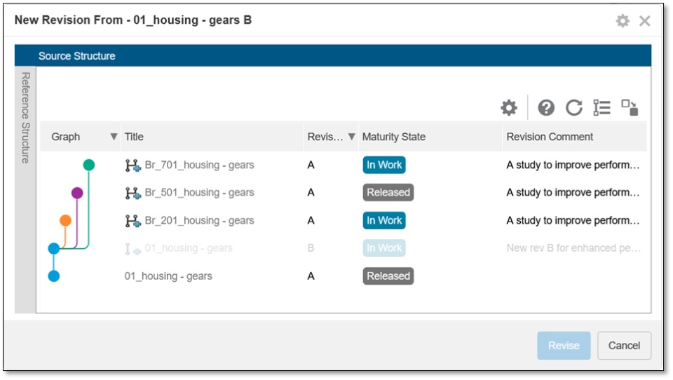

The revision Explorer will show all these relations:
  • 01_housing-gears Revision C:
    • is created from Revision B (blue line).
    • ​​​​​​Its content is copied from the branch Br_501_housing-gears (Revision A).
Note:

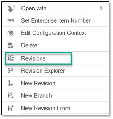

You can also use the “Revisions” option to view all these relations between the revisions and their branches:
Summary
Branching enables you to study alternatives, while components in production are not impacted by these studies.
The content of a chosen branch can be merged into a new revision that will contain the same content.
Here is a summary of the example above:
