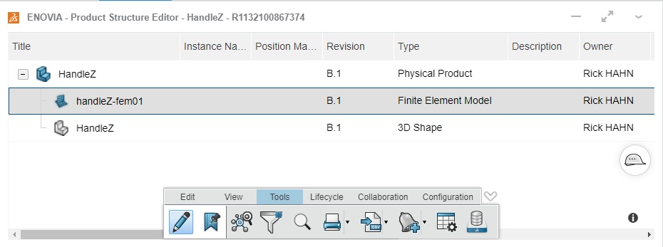

Within the product structure, the fundamental relationship between analysis and the CAD specification is shown, wherein the product revision is linked to the FEA model created by SIMULIA.

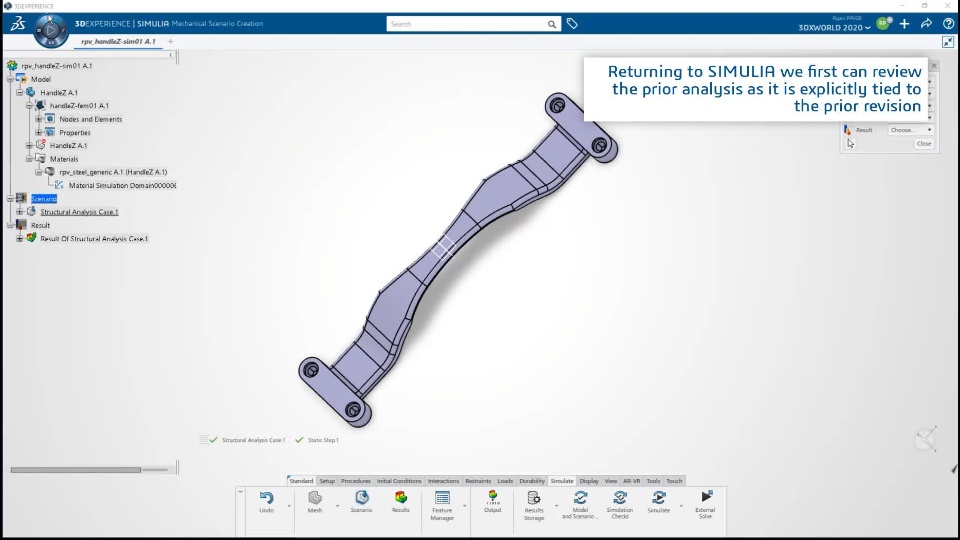

Analysis relationships then build on this as seen in the video. The focus of this scenario is simply to understand the fundamental relationships between the data in the 2 disciplines. My next BLOG will build on this by driving the entire operation through the change management tools of the platform.
