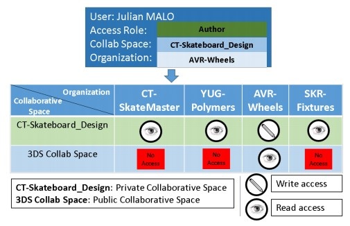

For example, in the use case pictured below: User Julian MALO is a member of the vendor organization AVR-Wheels and is added to the collaborative space and assigned with the Extended Author role. Julian MALO gets access to read data shared by other vendors in the collaborative space. In such a case, in order to keep the data privacy of the other organizations, the restricted roles are introduced.
Now consider: User Julian MALO is a member of vendor organization AVR-Wheels, and he is added to the collaborative space and assigned with the Author (restricted) role. Julian MALO now only gets read/write access to content owned by his organization, and only in the Collaborative Space he was assigned to.
