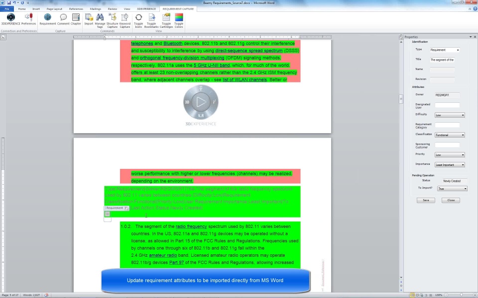

The first step to solving this problem is to digitize this content by bringing it onto the 3DEXPERIENCE platform.Different ways of doing this include requirements capture from MS Word, MS Excel and Reqtify. The video on this post is recorded in 17xFD05 and it shows what we offer for capturing requirements from MS Word.
In 18x this solution has been enhanced to include capturing sub-requirements from MS Word, but all other functions in the video are still relevant.
