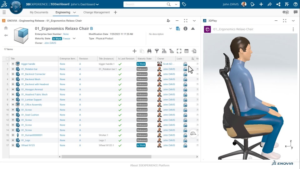

The following short video illustrates case 2 and 3.
