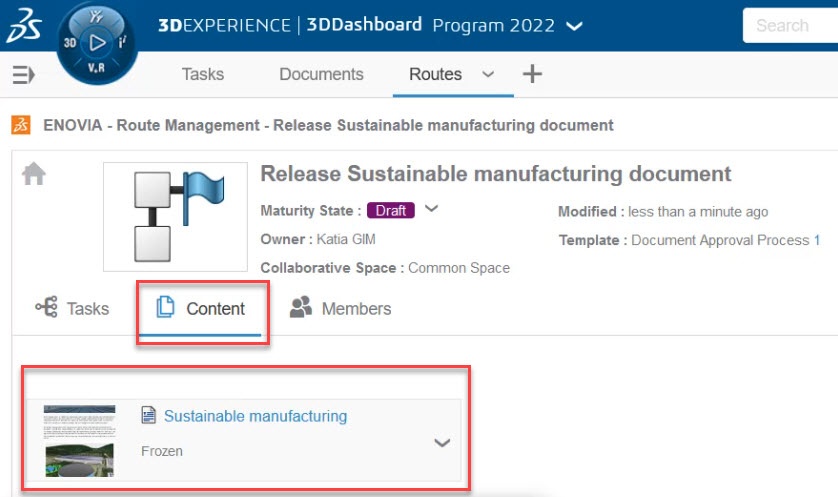

Routes can contain content that helps the route members complete their assigned tasks.

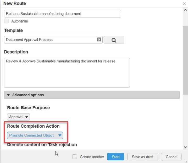

To add content to route, you drag the content either from the search results or from any other application and drop it into the route ‘Content’ tab or directly on the route itself.
If the purpose of the route is to approve its content, you can choose to promote automatically the content upon completion of the route, by setting the ‘Route Completion Action’ to ‘Promote Connected Object’ in the ‘New Route’ dialog.

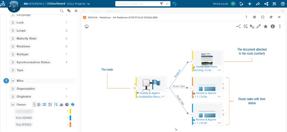

In R2022x FD01, the relation between the content and the route is available in ‘Relations’ widget including the route tasks. This enhancement improves the document approval process, impact assessment and audit trail.
