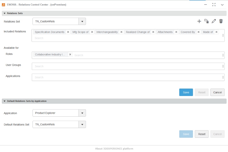

- The application UI:
- As you can see from above that I've created my custom Relations Set and default it for "Product Explorer" widget.

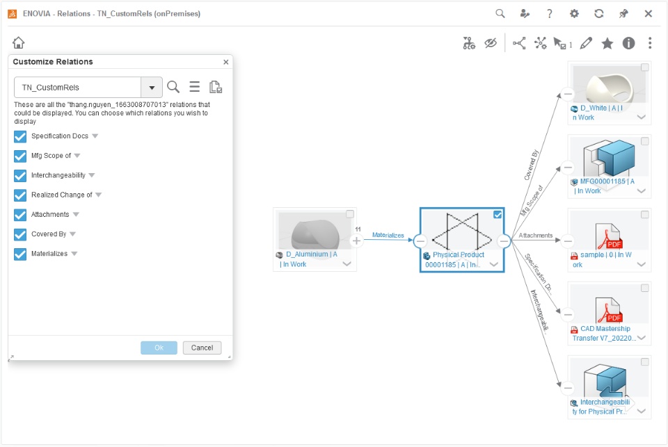

- Example of how we normally see an item's relations but selecting the custom Relations Set:
- Graph View:

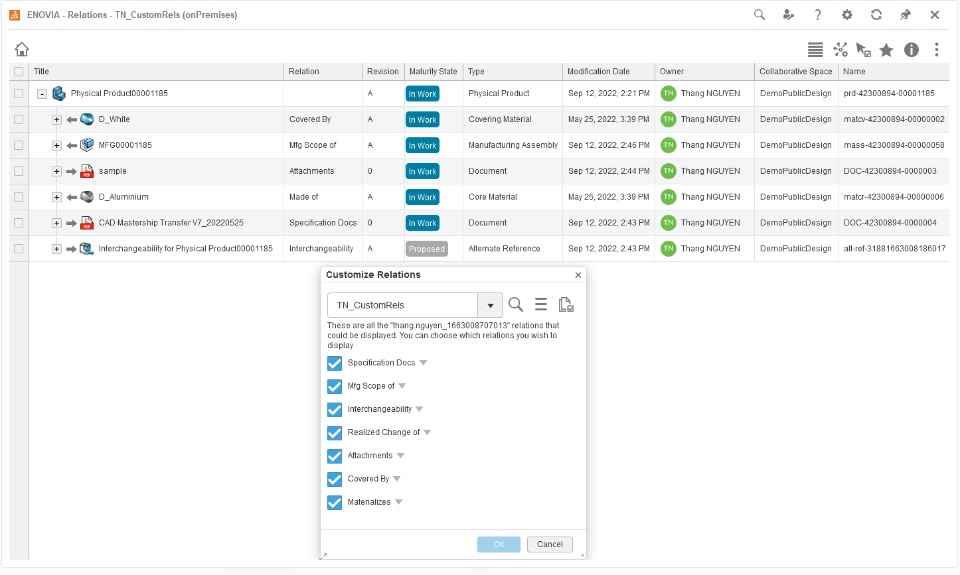

- Table View:

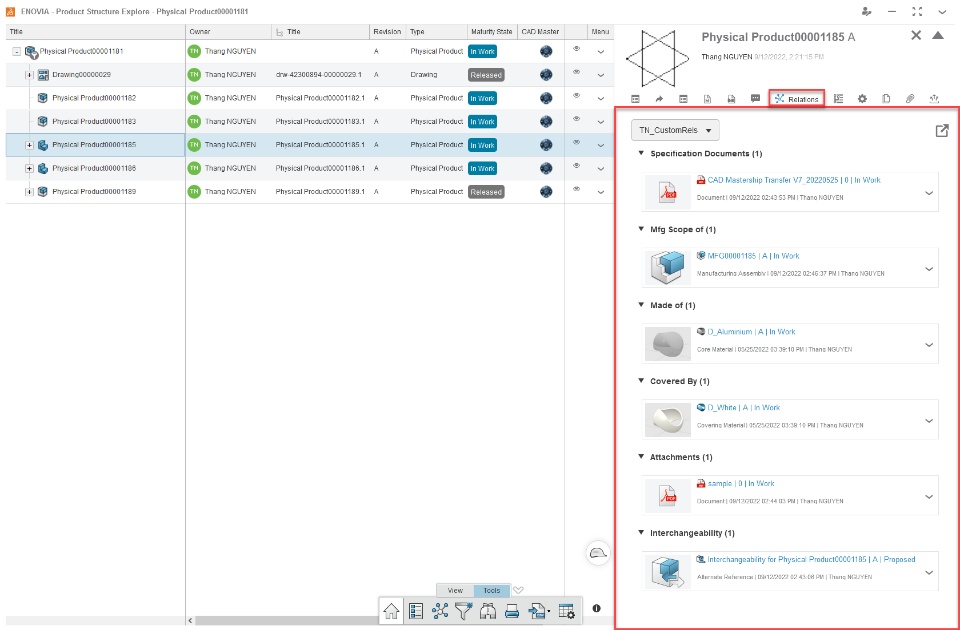

- Since I've set my custom Relations Set for Product Explorer application, it will use my custom Relations Set as default in the side panel. In addition, the first 10 patterns of my Relations Set are available to be shown as columns on the table view.
