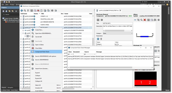

ENOVIA's Collaborative Designer for Altium offers designers the ability to perform design rule verification on electronic components developed for Altium Designer. Rule checking is available in the Electronic Component Editor so that components can be verified before they are saved into the 3DEXPERIENCE platform. Component rule checking verifies the integrity of the component (e.g. pin mapping between the footprint and schematic component), the symbol (e.g. consistency of the pin list between alternate view modes) and the footprint (e.g. pads that are shorted with a copper connection, in the example below).
The component rule checking is configurable so that the user can define the severity level reporting for each of the possible violations that can exist on a component. These reporting levels include:
  • All Off - set the Report Mode for all violation types to No Report
  • All Warning - all violation types are set to Warning
  • All Error - all violation types are set to Error
  • All Fatal - violation types are set to Fatal Error
