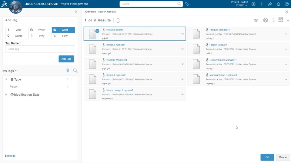

- At this point, the project leader has to create an issue in the “Experiments” portal and while creating this issue, the project leader has to attach the experiment to the issue, select an approver for the experiment and issue assignee.
- Once the issue is created, an approval route is automatically sent to the person designated as “Experiment Approver."
