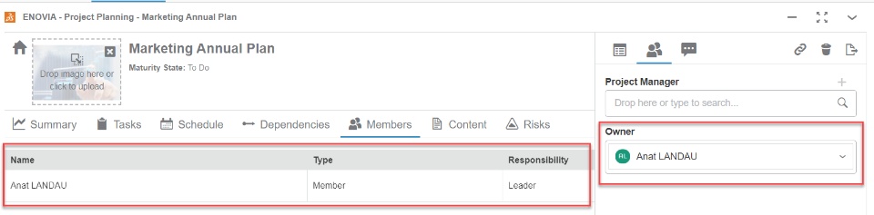

The user who creates the project becomes the Owner of the Project and is automatically assigned the Leader responsibility for it.
Each project is accessible only by its Owner when it is created.

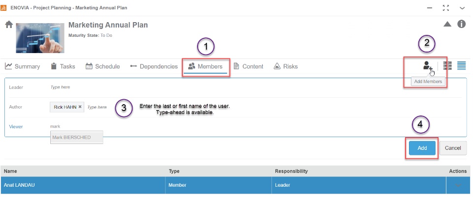

The Project Owner can add Project Manager and users as members of the project.
This is how you do it:
  • Use the Members tab, in Project Planning app, to add users as members of the project, and to assign them responsibilities (Leader, Author, Viewer)

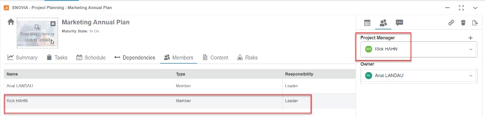

  • Use the Members tab in the Project Information panel to define the Project Manager, who is automatically assigned the Leader responsibility.
    It is possible to have several Project Managers assigned to a project.
    The difference between Project Manager and a user with Leader responsibility is that
    Project Manager sees the project in "My projects" section from the home page whereas the Leader does not.

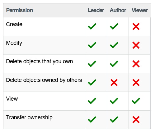

Each responsibility (Leader, Author, Viewer) defines a group of permissions for a project, including the ability to access it.
  • Leader has all permissions on the project, including deletion.
  • Author can modify all aspects of a project but cannot delete it. Author cannot add members.
  • Viewer can only see the project and cannot modify it.
The following responsibilities and permissions are relevant for all object types in Project Planning app:
