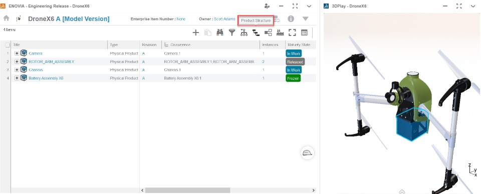

Product Structure
This view displays the products available in the immediate level under the root product.
This is the default view that enables you to focus on the content of this level, and navigate further as needed:

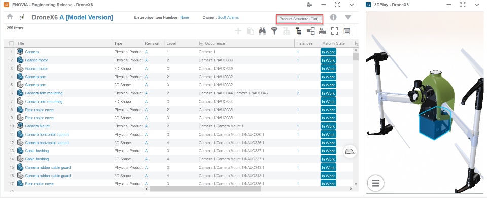

Product Structure (Flat) (New in R2022x FD03)
This view displays, as a flat list, all products of the root regardless of their level within the structure.
The columns “Level” displays where the product is available within the structure.
The column “Occurrence” displays where the instance is “used” within the structure: it shows the full path from the instance up until the root product

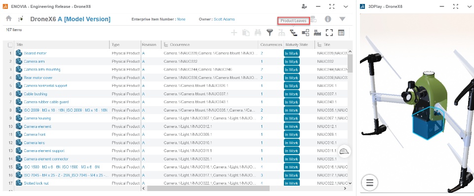

Product Leaves
This view displays, as a flat list, all products that are:
  • leaf products (products that have no children)
  • defined as “Terminal Items” (based on an attribute defined in the widget preferences)

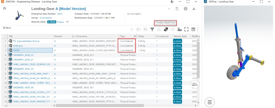

Product Made From
this view displays, as a flat list, all products that are:
  • Leaf products (have no children)
  • Defined as “Terminal Items” (based on an attribute defined in the widget preferences)
  • products that describe the consumed Core Materials
  • Raw materials (*)
(*) Raw Materials:
Raw materials are created using the role “Specification Manager (XSR) , and consumed by the Product Release Engineer to define from which materials the product is made of.
This role enables you to reduce launch times and eliminate costly re-authoring errors by utilizing design data directly in specifications.
Note: this role is currently available as a “Controlled Availability” (or CA) on both premise and on cloud

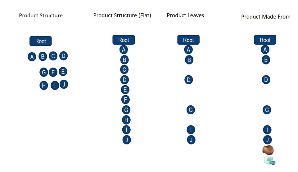

Summary:
To summarize, here is another example that illustrates the way these views:

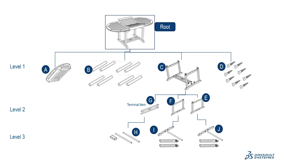

Example:
The root table is made of several products (A, B, C ...):
The various display options for this root would look like this:
