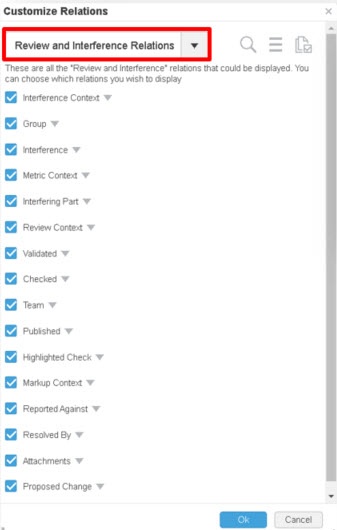

ENOVIA Relations enables the user to display the ecosystem of related objects by navigating on relationships and paths. Under the Review and Interference Relations section of the Customize Relations dialog box, the user is able to select filters to display the relations needed.

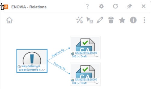

For example, during a review process, the user is able to view the related Change Actions for an Issue by selecting the Resolved By relation.

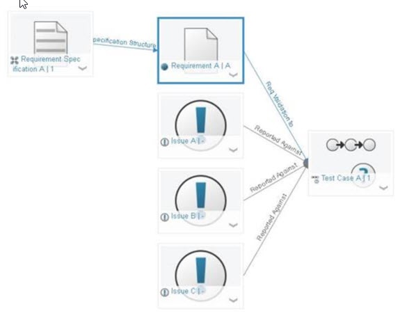

Or in the Requirements and Test Management domain, the user is able to display the relations among Requirements, Test Cases and Issues by selecting Req Validaton to and Reported Against relations.
