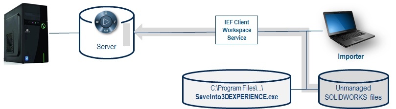

Prior to using the Dassault Systemes PLM Collaboration Services for SOLIDWORKS, customers often have accumulated many unmanaged SOLIDWORKS files. These customers usually wish to bring these existing SOLIDWORKS files into the 3DEXPERIENCE platform. Of course, they can do it manually by loading these files in a SOLIDWORKS Desktop interactive session and saving them directly to the 3DEXPERIENCE platform through the 3DEXPERIENCE PLM Collaboration Services task panel — but this one-by one approach could prove time consuming for many scenarios.
Since R2018xFD04, the DS batch command-line utility has the ability to save one single file, assembly or drawing, or an entire directory of such files into the 3DEXPERIENCE platform.
Saving SOLIDWORKS files into the 3DEXPERIENCE platform using this process, involves three components:
- A new command-line executable provided on the client via the SOLIDWORKS Connector installation (SaveInto3DEXPERIENCE.exe). Note that the default location is:
C:\\Program Files\\Dassault Systemes\\B420xcadconnectors\\win_b64\\USWC\\
- The IEF Client Workspace Service
- The server
Saving SOLIDWORKS assembly structures this way is similar to saving the said structures from a SOLIDWORKS interactive session.
