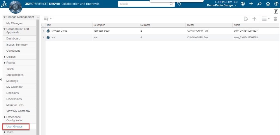

A new User Groups menu is available in the Collaboration and Approvals application in 3DSpace.
Users with the Leader or Author baseline access roles are able to create User Groups. These User Groups can be used as task assignees in routes. A new User Group is created by selecting on the “+” command in the menu.

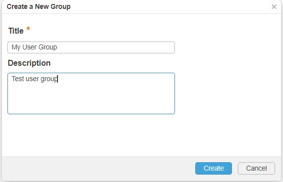

A new User Group is created with a mandatory Title and optional Description.
