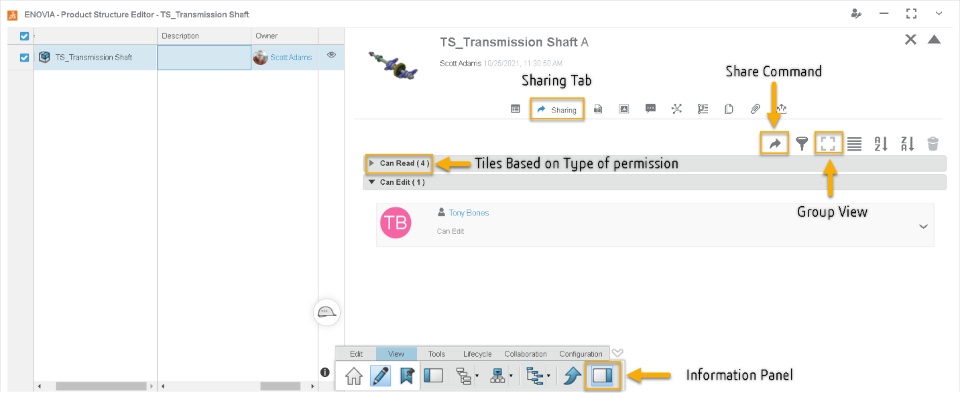

Image 1: Sharing tab in the Information Panel of Product Structure Editor
You can view the permissions granted for an object, modify them as required or remove them.

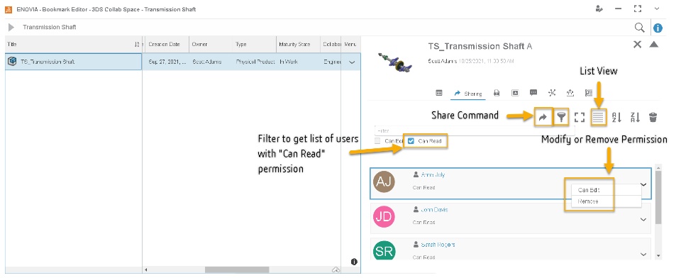

Among the two available views, the “Group view” groups the tiles based on the permissions, and the “List view” shows the flat list of users with whom the object is shared. If the object is shared with multiple users involving multiple types of permissions, you can apply a filter based on “Permission Type”.
Image 2: Sharing Tab User Interface

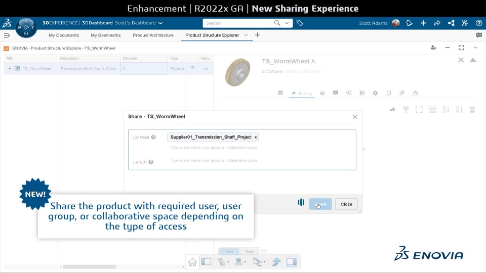

Please refer the following video for more information about the new Sharing tab.
