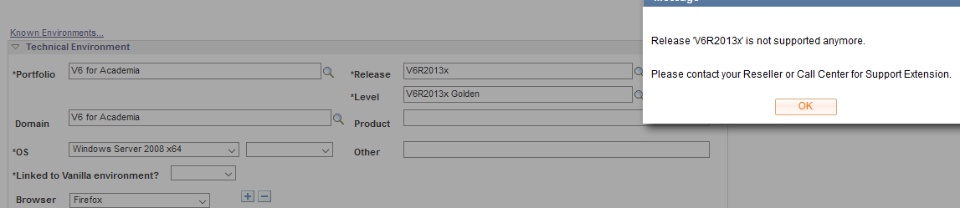

We all know that V6 2013x is not supported anymore (See attached )

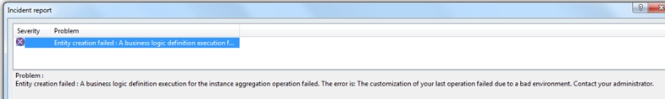

CATIA V6 2013x Problem Attached (
encountered issues during the 3D Propagate ( or Check-in ) Function.
"Entity Creation Failed Error" ( not Found in the DS KB )
Procedures to re-create the Issue:
  1. Imported CATIA V5 Files.  ( import Successful )
  2. Create new 3DFiles
  3. Execute Propagate (Save / Check-in) function:
    Problem Description/Question: Catia V6 cannot create part and assemby
Specific setup: CATIA V6 2013x
SERVER : PLMEXPRESS 2013x
Action taken for fix/troubleshooting:
ACTION DONE
RESULT
Test Connections – OK & test Propagate
SAME ERROR – NOT RESOLVED
Re-login Users & test Propagate
Restart Server & Services – Apache / Oracle
Delete CLIENT CAT Settings:
Delete Client CATIA Cache /TEMP:
Login to Different Security Context
May I know if there’s a way to resolve this issue by deleting or refreshing something in the server or the client side?
