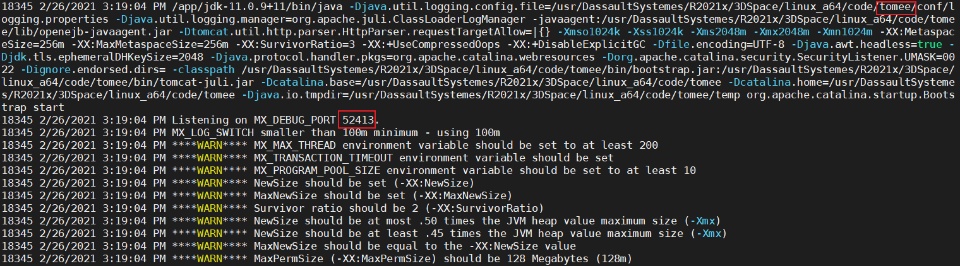

There is an debug port provided when 3DSpace tomee begins for every start. It will display all the current connection and related information used by this tomee. This will be very useful for performance issue investigations.
The below steps shows how to get this information.
First go to 3dspace/logs if you are using R2019x or below. Go to 3dspace/logsCAS is you are on R2020x or above.
tail -100 mxAudit.log
You found the debug port is 52413

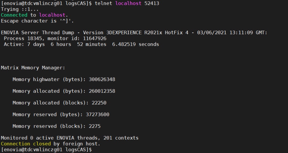

Then telnet localhost 52413, and then press twice enter, below shows there is no connections at this time.

[enovia@tdcvmlinczg01 logsCAS]\\\$ telnet localhost 52413
Trying ::1...
Connected to localhost.
Escape character is '^]'.
