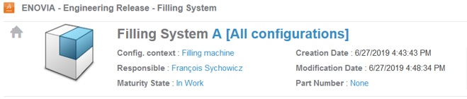

An Engineering item is “configured” as soon as it is associated with a Model as “Configuration Context”:
These Engineering items are, by definition, managed through a configuration, and NOT through lifecycle maturity. As such, they should not be:
