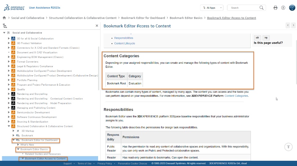

Step 1: How to locate the Object Content Category:
To know what is the lowest responsibility required to create an object, you need first to know to which 'Content Category' the object belongs.
In general, we support five types of Content Categories:
  • Administrative Resource Management
  • Authoring Resource Management
  • Definition
  • Evaluation
  • Personal Management
To find the 'Content Category' the object belongs to, follow the below steps:
  1. First, identify in which application we create the particular object.
  2. Then, open the main application section in the ENOVIA User Assistance documentation.
  3. Under the application section, navigate to: ' Basics' -> ' Access to Content' section.
  4. In the ' Access to Content' page, refer to the 'Content Categories' section, to identify the 'Content Category' the object type, created in this application, belongs to.
For example, to create a Bookmark, you work in the 'Bookmark Editor' application. Therefore, in the ENOVIA User Assistance documentation, you navigate to:
'Bookmark Editor'-> 'Bookmark Editor Basics' -> 'Bookmark Editor Access to Content'.
Then, you see that 'Bookmark Root' belongs to the Evaluation category.​​​​​​​

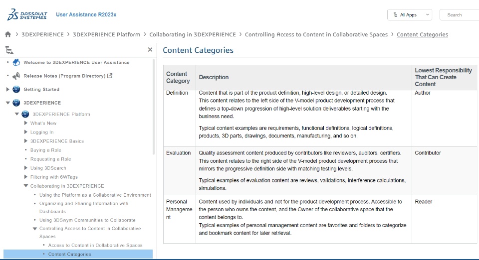

Step2: Locate the Lowest Responsibility that can create the object:
Now that you know the 'Content Category' of the object, you are ready to locate what is the lowest responsibility required to create the object.
  1. In ENOVIA User Assistance documentation, navigate to
    3DEXPERIENCE ->3DEXPERIENCE Platform->Collaborating in 3DEXPERIENCE -> Controlling Access to Content in Collaborative Spaces-> Content Categories.
  2. On the 'Content Categories' page, there is a table describing for each 'Content Category' the Lowest Responsibility required to create content.
