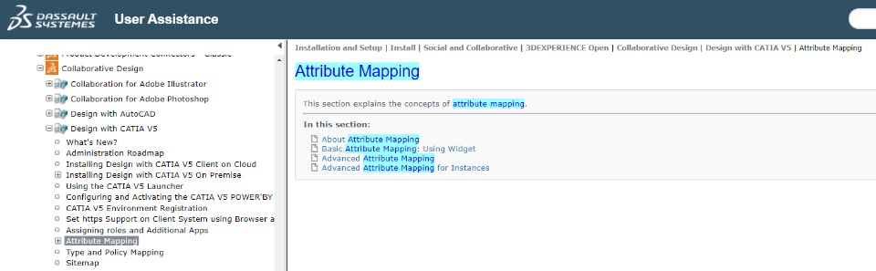

Before we get started I would like to note that I created the material below on the public cloud (R2021x FD06) connected to CATIA V5 B30 HF9. Also note that the topic of attribute mapping for CATIA V5 is covered in the documentation under Installation and Setup | Install | Social and Collaborative | 3DEXPERIENCE Open | Collaborative Design | Design with CATIA V5 | Attribute Mapping

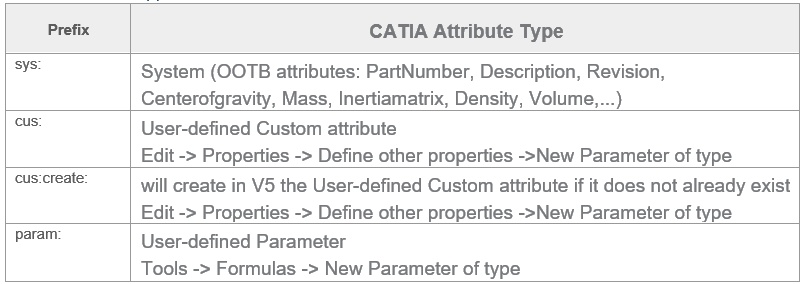

Noting the rules from the documentation below...

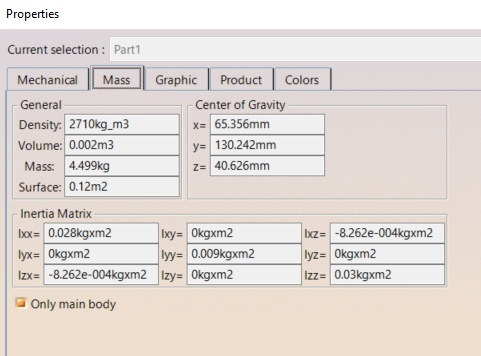

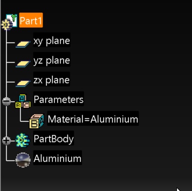

Within CATIA V5, we would have the following system attributes mapped.
Volume and Material

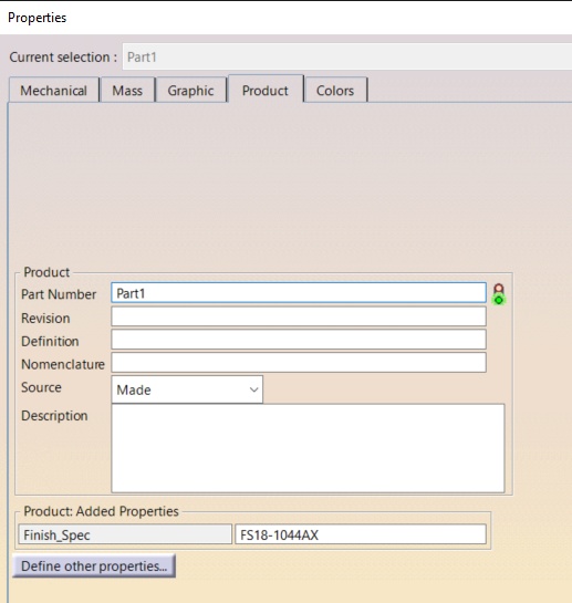

And the following users attribute...
Finish_Spec

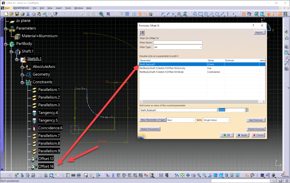

Finally we have the parameter (Shaft_Radius01) which I have renamed to match the previous mapping using CATIA V5 Tools> Formulas...

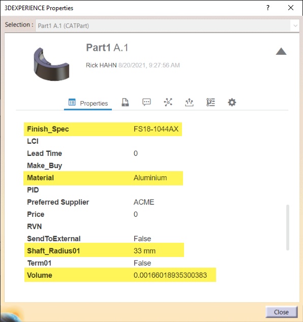

​​​​​​​Once saved to the platform, we see the results in the mapped output of these 4 attributes in the 3DEXPERIENCE property sheet...
