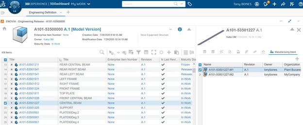

A new tab, “Manufacturing Intent,” available from the Engineering item, displays these relationships between Engineering and Manufacturing items:
Note: this new capability does not require a DELMIA role to be granted to the user (such as Manufacturing Item Manager (MFN)).

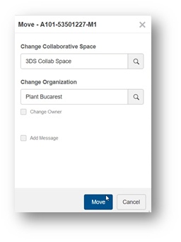

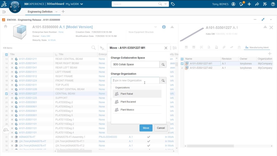

After establishing this relationship, the release engineer can assign the “plant responsibility” for each Manufacturing item. This will move the ownership for the item into this plant.
A “plant” is represented by both “Collaborative space” and “Organization.”
The following video illustrates these new enhancements, which accelerate the manufacturing definition to be directly established from the engineering definition.
