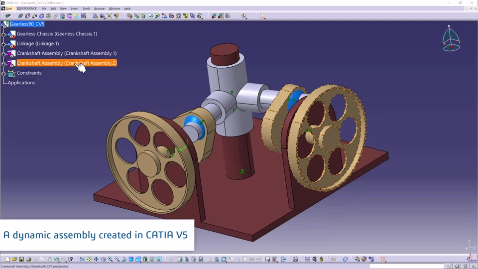

To better understand the challenges of viewing this data, let’s first take a close look at these kind of assemblies in CATIA V5 and SOLIDWORKS. Let's consider the dynamic assembly below, in CATIA V5, which changes the direction of rotational power 90 degrees without the use of gears.
The designer has two ways they can structure the product and the constraints:

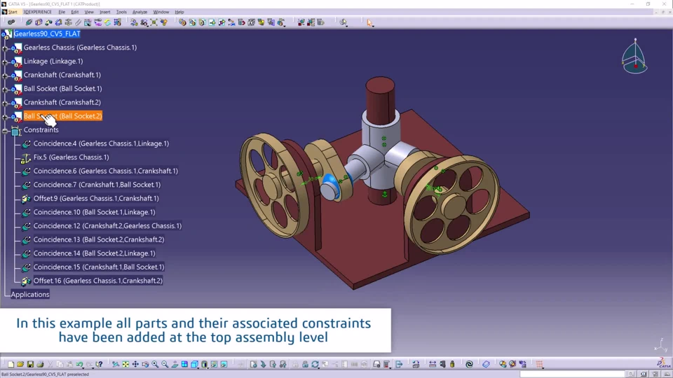

- Build a flat assembly with all constraints at the top level of the assembly

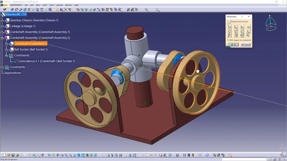

- Build a more realistic system where sub-assemblies are created and instantiated into the top assembly. This option reduces the number of overall constraints that must be created as they are already defined in the sub-assembly. This also results in product structure that closely mimics the assembly process downstream once the product reaches the manufacturing stage of development.

The example illustrated utilizes the second way mentioned above:

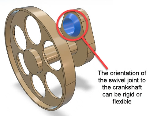

it uses two instances of a sub-assembly (Crankshaft Assembly). These assemblies have their own kinematic joints that must be defined. As you can see in the example, this introduces a problem – the subassembly cannot be “rigid” since the parts that make it up are different in each instance at any point during rotation. This is the reason CAD systems offer “flexible assembly” functionality:
the system has the ability to ignore the static relationship that exists within the sub-assembly for different instances.

In the current releases of the platform, the only effective way to address this issue is to handle dynamic assemblies like this by moving all the parts that are affected to the top level of the dynamic assembly. Note that this is not always the top level as the dynamic part of the structure may be defined within the context of a larger machine system. We can see the result of a flat assembly in the video below...
