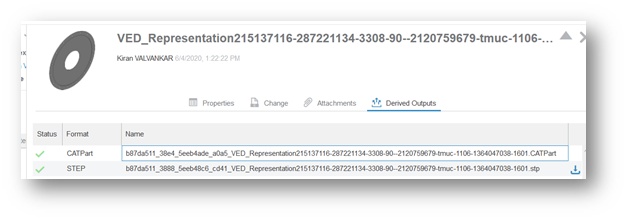

CAD Documents – Derived Output
Derived outputs are secondary files generated from conversion to another format of the master CAD file (3D or 2D) of an object.
As CAD documents are stored in the platform as “Engineering Items,” their derived outputs are captured as “Derived Outputs” which will be attached to the Engineering Item. These derived outputs can only be displayed in the platform and managed from the CAD application.
Note: derived outputs for Engineering Items are not “attachments”. You can still add “Attachments” to Engineering Items as well as “Specifications” using widgets like “Engineering Release.”
