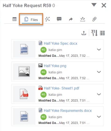

A new tab is available in the Document Management widget, called 'Files', which is available in the Document Information panel.
Using the Files tab, you can:

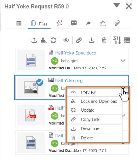

  • Upload new files into the selected managed document
  • Preview, update, edit, download, and delete each file separately.

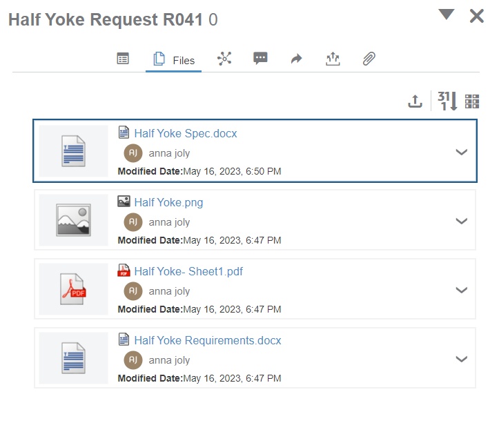

Two views are available in the Files tab:
Tile View – Displays the files with some information such as the file name, the file owner and the modified date.
The Tile View cannot be configured.

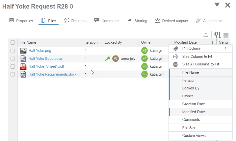

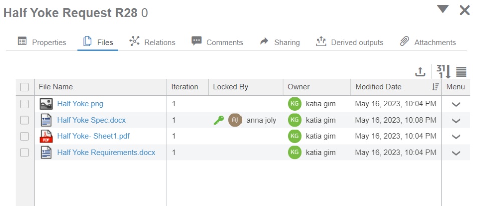

Data Grid view – Displays the files in a table format.
By default, the Data Grid view displays the following information:
  • File name
  • Iteration – every time you edit the file, the file has a new iteration
  • Locked By – Indicates if the file is locked and by whom
  • Owner
  • Modified Date
 You can configure the Data Grid table to display more information about each file, such as the File Size, the file Creation Date, File Extension and more.
