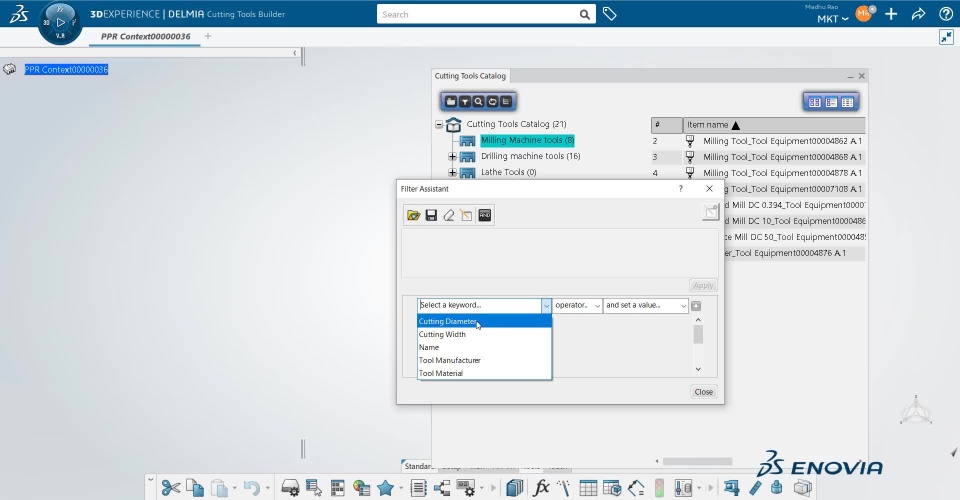

Further in the video, I also show how the users can leverage the classification of tools directly in the cutting tool builder app in DELMIA. It’s the same concept.. search the catalog, apply the needed attribute filter, and once the correct tool is identified, just insert it into the PPR context in the session.
When a new tool is created, it can be easily saved into the platform and classified into the appropriate class. What I haven’t shown in the video is how the attribute values that get generated when a tool is created, get saved into the appropriate library. This is achieved through configuration that maps the attributes from the tools to the library classes.
