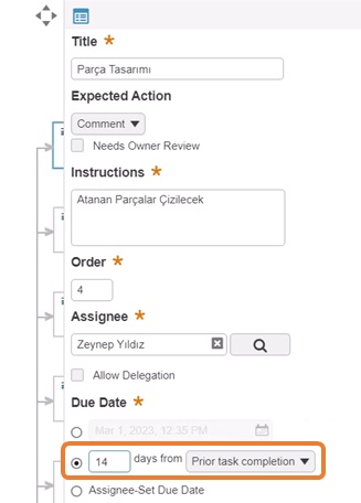

Project Planner @EC adds the condition for completing the prior task to the Due Date while creating the route. With this condition, the new task will not be allowed to start until the previous task is approved.

4. Part Design (Parça Tasarımı)
17 team members responsible for the design of the parts in the technical drawings of the Locomotive Project were assigned.

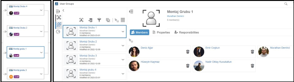

6. Assembly Groups (Montaj Grupları)
4 groups were formed to make the sub-assemblies. These groups include team members responsible for assembly. The team members in the groups are included in the user group with the same name.
