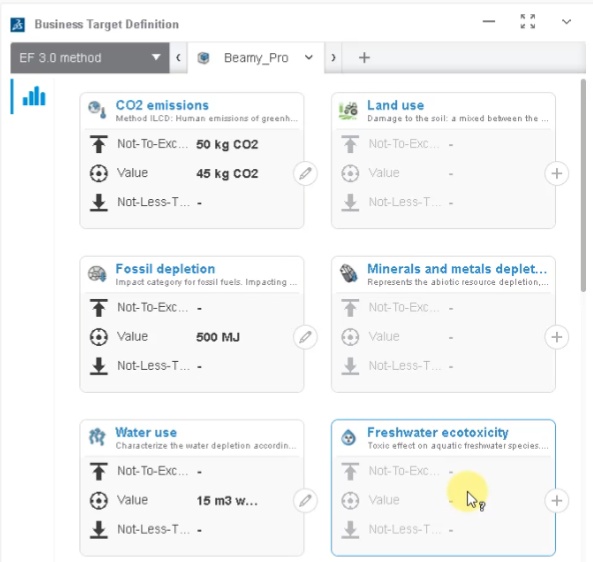

1) Define Environmental and Weight Targets
The “Business Target Definition” app allows you to set up the goal and scope definition i.e. you can set up “Target Value”, “Minimum Permissible Value”, and “Maximum Permissible Value” for all the environmental metrics depending on the environmental method you’ve chosed.
For example, with the EF 3.0 environmental method, you can set up these values for the 16 key environmental metrics such as CO2 emissions, ozone layer depletion, water use, land use and more.
Setting target values for the environmental metrics using Business Value Definition app
You can set up these targets for the main product and then cascade the targets to sub-system (parts) level as well.
Note: The Business Target Definition app supports the following five environmental methods to perform life cycle assessment: IPCC, EF3.0, ReCiPe, EPS, TRACI.

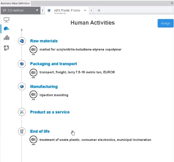

The Business Value Definition app allows you to assign human activities to the product or specific part in the product structure. You can select a part and assign these activities to one or more life cycle phases shown in following image:
                               Life cycle phases to which the human activity can be assigned
Note: A human activity in this case is an action done by  the person that influences environmental metrics and footprint. Human activities are categorized based on International Standard Industrial Classification (ISIC) concerning various economic sectors that contribute to the environmental footprint.
    Assigning Human Activity available in the ecoinvent database to the relevant life cycle phase
                    Different human activities assigned to ABS Plastic Frame’s life cycle phases

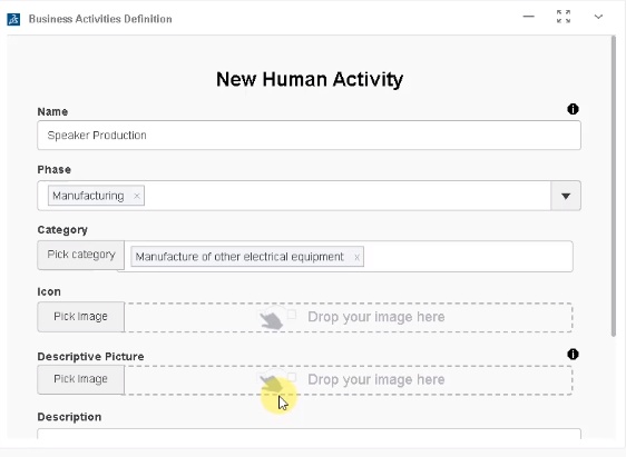

3) Create Custom Human Activities
Along with the 18000 activities already available in the ecoinvent database, you can create your own custom human activities as required. The Business Activities Definition app allows you to create custom human activities affecting environmental footprint. These activities can be assigned to the product or its part. These activities are also helpful to enrich the database and can be used for future projects.
                    Creation of the new custom human activity in Business Activities Definition app
You can add the formula to calculate the contribution of the activity to the environmental footprint. This formula can be estimated, computed, declared, or measured. You can also assign tolerance and confidence value to the activity formula as required.

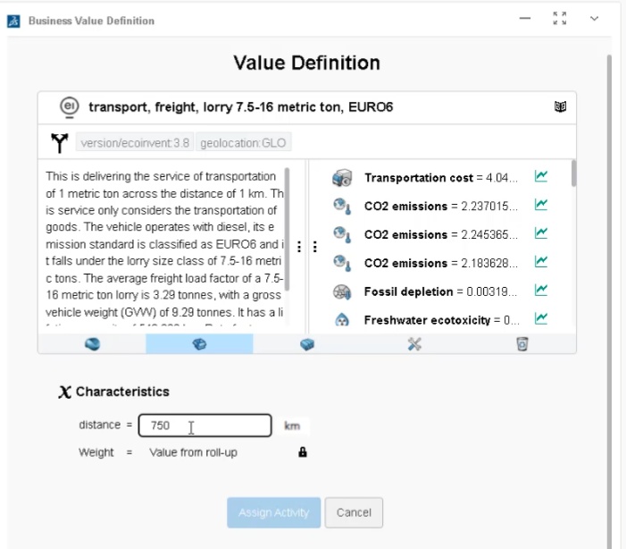

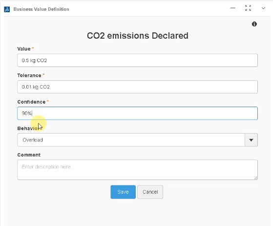

4) Declare Environmental Impact
Most often standard parts like fasteners are procured from the supplier. Supplier may have already performed life cycle assessment of these parts and you can reuse this assessment by declaring values of the environmental metrics (For example: CO2 emission) in the Business Value Definition app.
                        Declaring the environmental metrics in Business Value Definition app

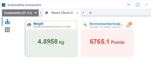

Overview tab
The Overview tab in the Sustainability Assessment app shows you the Environmental Footprint and the Weight value of the selected product or its part. Color code indicates whether the value is within the set permissible limits or not.
                                    Overview of the Weight and Environmental Footprint values

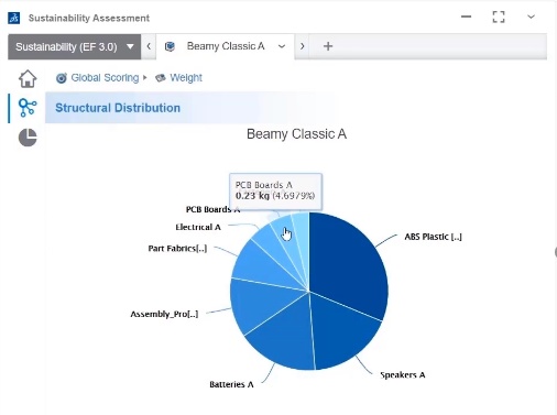

Structural Distribution Tab
In the Structural Distribution tab of the Sustainability Assessment app, you can see a pie chart that shows the contribution of each part (Sub-system) within the assembly and it’s environment metric value.
                                        Structural distribution of the environmental footprint

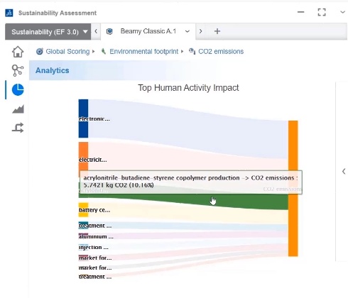

Analytics tab:
The Analytics tab in the Sustainability Assessment app allows you to view analytics for the phase-wise distribution, environmental footprint breakdown, and most impacting human activities. The Sankey diagram shows the top ten human activities contributing to the selected environmental metric.
               Sankey diagram showing impact of human activities on the environmental footprint

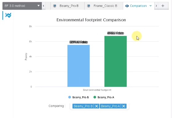

Performing trade-off studies:

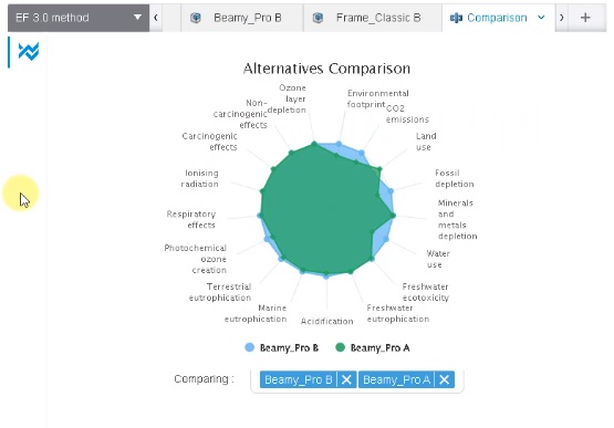

You can create revisions of the products and compare their environmental impact to take better decisions and comply with the set environmental footprint targets. The “Add to Comparison” option in the app allows you to begin the comparison. The spider chart is displayed that shows the comparison of each environmental metric value of the selected revisions. You can click on any of the metric to view the result in the bar chart form.
              Spider chart showing comparison of each environmental metric value for 2 revisions
                    Bar graph showing comparison of environmental metric value of 2 revisions
