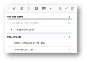

  • Add more risk information
    • Add Affected Items - Items, which are affected by the risk.
    • Related content - Attach documents to assign as an attachment

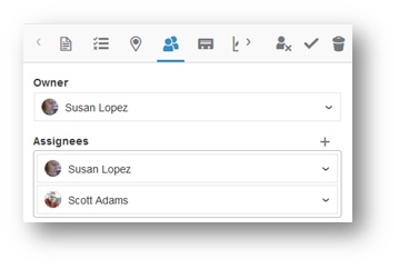

  • Assignees – The people assigned to work on the risk
    Assign the risk to other users to start working on it

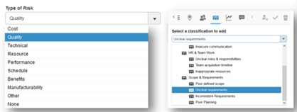

  • Classify the Risk
    • Setting the type of the risk, which includes an OOTB list of values such as: Cost, Quality, Technical, Schedule and more.
    • Classify Risk in library classes allows you to extend the type of risk OOTB list without customization.
      If classification attributes exist, the risk acquires the class attributes.

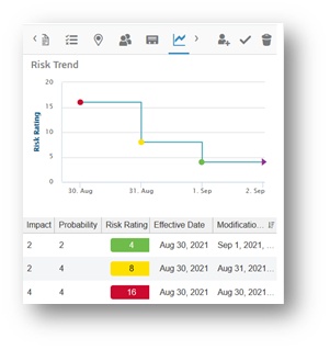

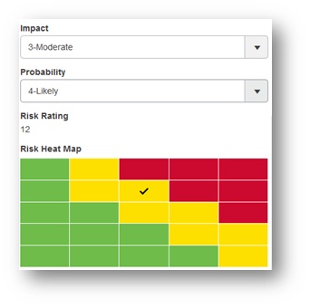

  • Risk RPN (Risk Priority Number) and Risk Trend
    • In ENOVIA, the RPN is also called Risk Rating or Risk Factor, which is a combination of Probability of Occurrence and the Impact of the Risk. A higher RPN number represents a more critical risk.
      The system calculates the RPN value by multiplying the probability value by the impact value. The probability and impact values can both range from 1 to 5 ( 1 being the lowest and 5 the highest). Therefore, the RPN can range from 1 (1*1) to 25 (5*5).
  • Risk Trend is a chart shows the trend over time whenever Risk Rating values change. As risk management is a continuous process, the risk owner can set different values of the risk rating over time.

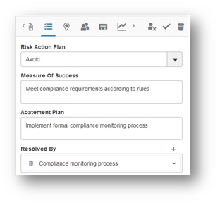

Mitigate/Control
At this point, the project team is ready to develop responses to the risk and assess remedies to manage the risk by developing a plan and putting it into action.
The best action would be to prevent the risk from occurring, but sometimes the only available action is to mitigate the risk or simply control it.
  • Define and track the Risk Action Plan
    Here we define what is the action to be taken to mitigate the risk and how we measure the success. We set the “Risk Action Plan” type, the “Measure of Success”, the Abatement Plan,” and then select the task or project we plan to resolve it with.

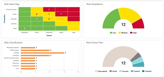

Monitor
Now you can monitor Risks based on color charts
Using the summary view that contains four color charts, you can monitor:
  • All risks
  • Risks owned by you
  • Risks assigned to you
With these charts, you can have a quick glance at the key indicators:
  • The heat map is a two dimensional chart, based on probability and impact. It shows the number of risks belonging to each probability and impact category.
  • Risk Breakdown chart has three categories of risks: Low, Medium, and High. The colors match the Risk Heat Map. The total count of all risks is displayed in the middle of the pie.
  • Risks Classification chart displays the number or risks in each risk classification (type of risk & Library class).
  • Risk Action Plan chart displays the number of risks based on the Risk Action Plan type.

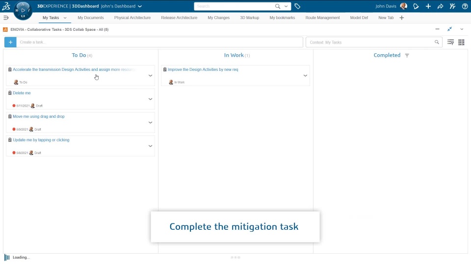

The  following video illustrates the ‘Risk Management’ app in more detail:
