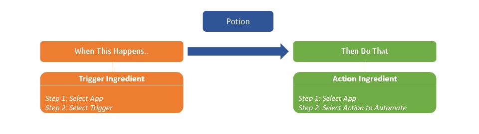

Trigger Ingredient
Trigger Ingredient allows you to set a "When this happens" condition, which is typically an action performed in one of the apps in the 3DEXPERIENCE Platform that triggers the potion (*).
You can follow below steps to define a Trigger Ingredient:
  1. Select the app. Example: Document Management.
  2. Select the action (= the trigger). Example: Document Maturity Changed to Released.
Action Ingredient
Allows you to define the actions that you would like to automate when the Trigger Ingredient's conditions are met. Example: Publish a 3DSwym post with a specific title and link to a document when its maturity state is changed to “Released”.
(*) Potion
A potion contains one Trigger Ingredient (“When This Happens”) & one or more Action Ingredients (“Then Do That”). When the Trigger Ingredient’s conditions are met, the app executes the Action Ingredients automatically, thereby saving time.
A potion can have one Trigger Ingredient and up to five Action Ingredients.

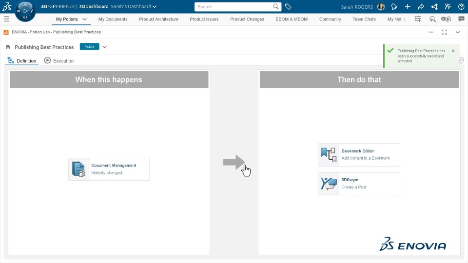

Demonstration
You can refer to the following demo video that explains how you can automate tasks such as adding released document to a specific bookmark and notifying stakeholders through a 3DSwym post.
