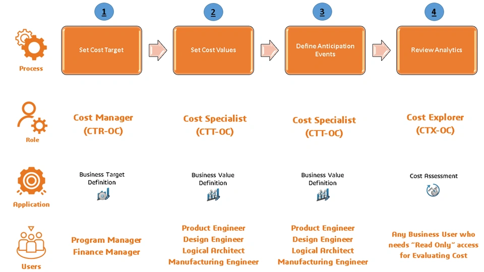

The following image displays a simplified view of the ENOVIA cost management process, roles, applications, and potential users involved in the process:
Note: The Cost Manager (CTR-OC) role also includes the Business Value Definition & Cost Assessment apps. The Cost Specialist (CTT-OC) role also includes the Cost Assessment app.

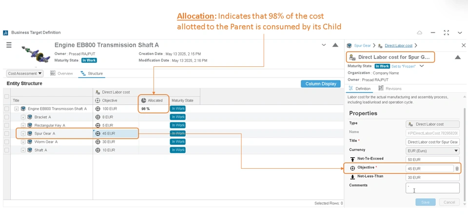

1) Set Cost Target
You can set-up cost objectives for your products at the start of your product development process.
This is essential to assess how well your objectives align with actual cost values during the product development process.
To do that, you can open your product structure in the app and setup cost targets. You can setup cost target for all the levels in the product structure. The allocation column indicates how much of the allotted cost for the parent item has been used by its child items.
While defining the cost target, you need to select a specific: currency, cost objective & its limits.
You can leverage lifecycle states to indicate the maturity of the cost. Cost targets can also be revised to manage cost evolution over the time.

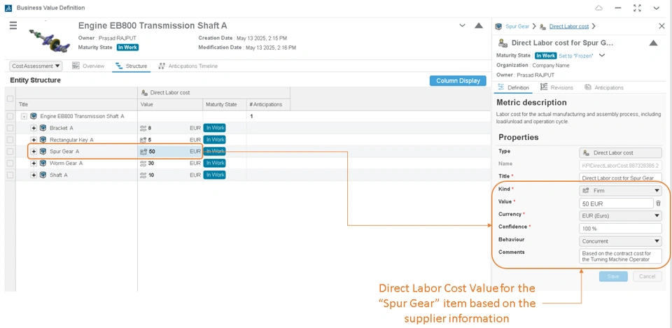

2) Set Cost Values
You can specify cost value for all the cost categories selected during the cost target definition. While doing this, you can specify its Kind (Type) to indicate whether it is an actual value or an estimated value. You can also mention how much confidence you have while specifying the cost value and use other cost attributes such as comments to add more details and explanation.

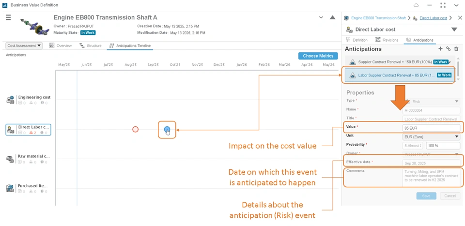

3) Define Anticipation Events
To assess the impact of the future risks or opportunities on product development costs, you can define anticipation events.
For each item in your product structure, you can select the type of event and specify its date and its impact on the cost value.
An example of such an event would be: increase in product development cost due to supplier contract renewal. In such a case, you can create a Risk event and specify the increased cost value and the anticipated date of the contract renewal.

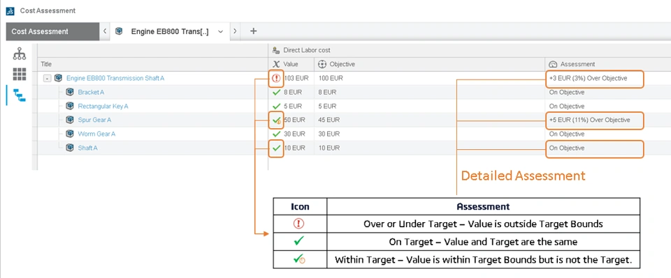

You can evaluate cost performance to assess how well your Cost Targets are aligned with the Cost Values.
To do that, you can open your product structure in the Cost Assessment app. To perform cost assessment for each item within your product structure, refer to the icon before the cost value that indicates the status of cost alignment for the given item.
The following image displays Multi-list View with the Direct Labor Cost assessment for the entire product structure. If required, you can configure the column view to add more cost categories in the table.
Note: You can click & open a specific product within the structure and view its cost analytics separately in a sperate tab.

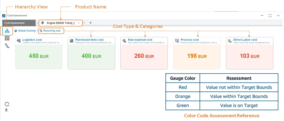

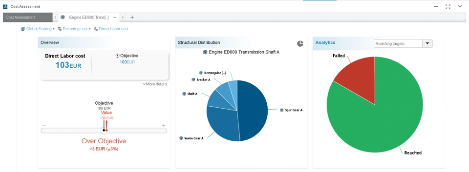

You can also refer to the “Hierarchy View” that lists all the cost categories within Recurring & Non-Recurring cost taxonomies along with their cost performance.
You can click on any category and view its dedicated analytics which involves Cost Overview, Structural Distribution to identify highest contributing parts, and parts that are reaching targeted cost.

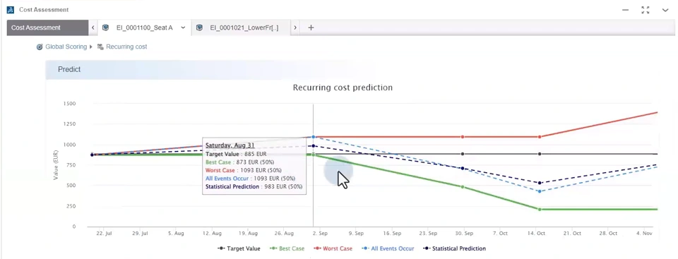

The Timeline View allows you to perform cost forecasting by assessing the impact of the future risks or opportunities on product development costs. This is derived based on the anticipation events with their timelines defined for the product.
