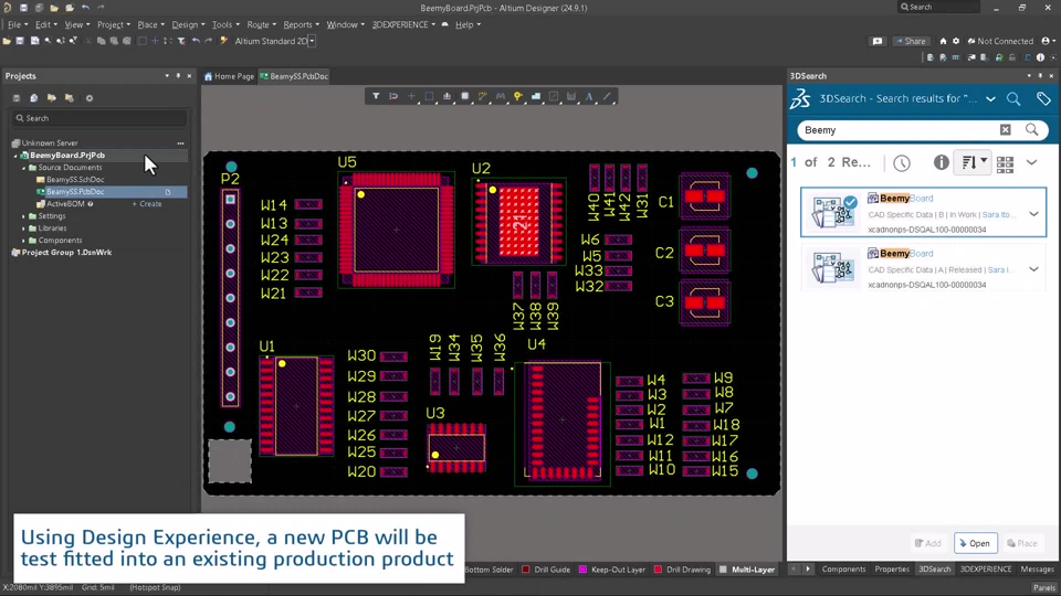

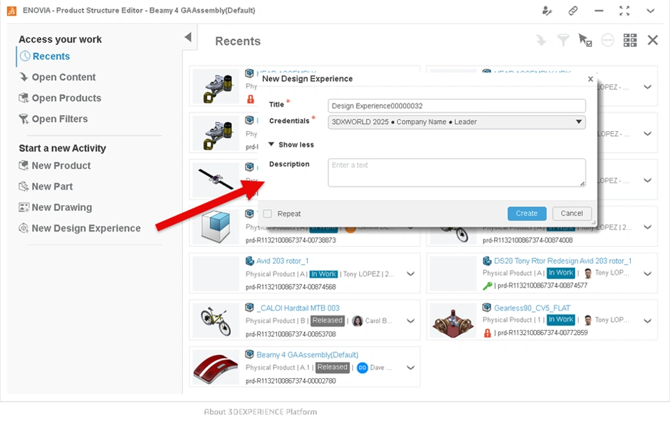

The basic workflow for working with a Design Experience involves the following 5 steps:
Here is an example of how the Design Experience can be used in the what-if development effort:
