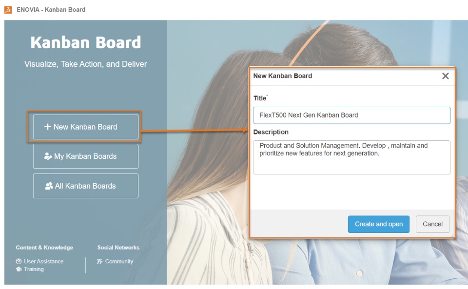

Define a new Kanban Board
  1. Create a Kanban Board; give it a title and a description.

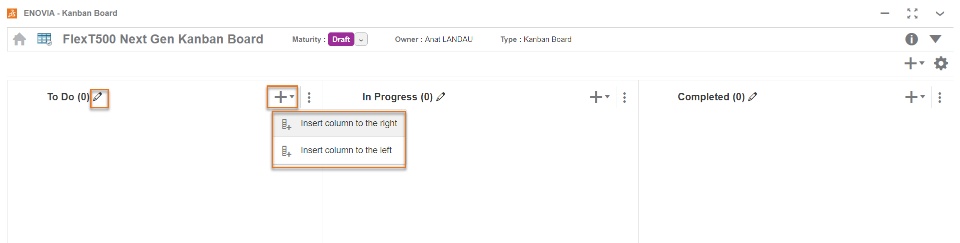

  2. Define the process flow:
    By default, three columns are created:
  • ​​​​​​​​​​​​​​​​​​​​​'To Do'
  • 'In Progress'
  • 'Completed'
    You can add or remove columns, and modify their names according to your needs.

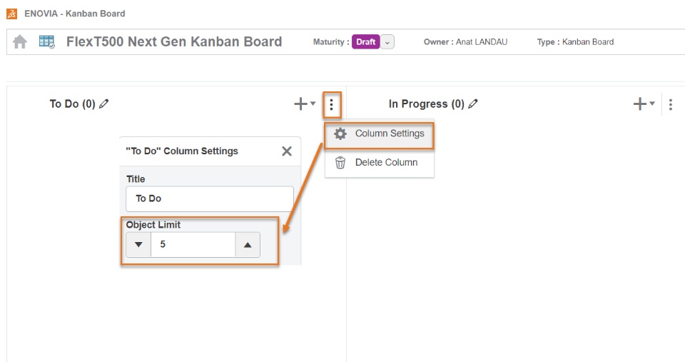

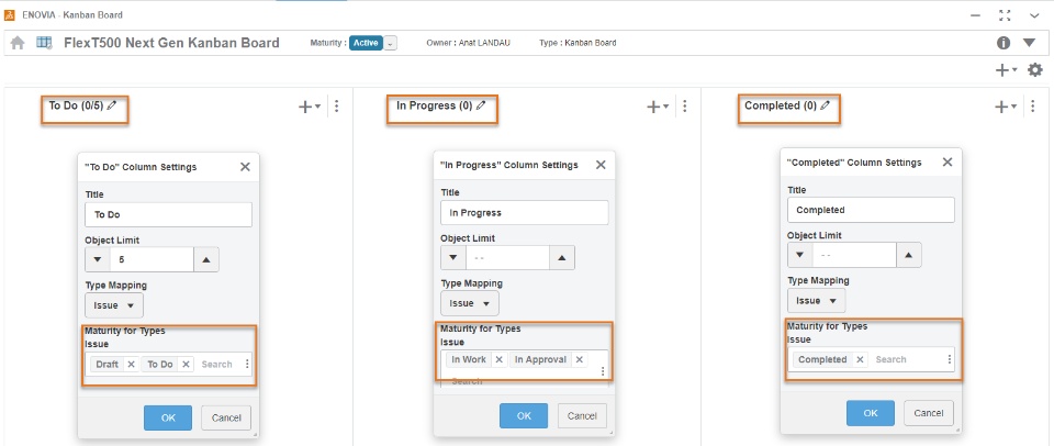

    ​​​​​​​3. Limiting the number of cards in a column
    You can specify a maximum number of cards that members can add to a column to control the workload assigned to a team.
    When the limit is reached, users can no longer drop a new card in the column.

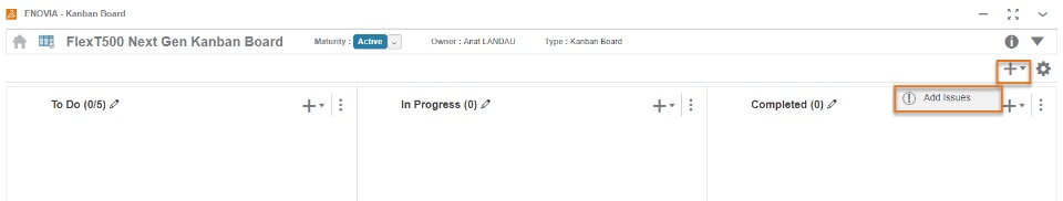

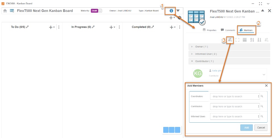

    ​​​​​​​4. Add members to the Kanban Board.

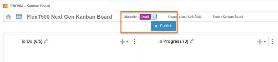

5. Publish the Kanban Board to make it available to other members.
Working with Work Items in the Kanban Board
  1. Adding Work Items to the Kanban Board
    You can now add objects to the Kanban Board and visualize them in the different columns.
    Each object is represented by a single card in the Kanban Board.
Note: You can only add object types allowed for the Kanban Board.
2. Moving Cards to Another Column
You can move a card to another column of the Kanban Board when a task on the corresponding object has been completed.
Kanban Board and Maturity Stages
You have an option, to map each column in the Kanban Board with one or several actual maturity states (of objects).
By default, the columns are mapped with the following Issues maturity states:
  • To Do column: Mapped with Draft and To Do maturity states
  • In Progress: Mapped with In Work and In Approval maturity states
  • Completed: Mapped with the Completed maturity state
In that case:
  • When you add objects to the Kanban Board, the objects are added to the column mapped with their current maturity state.
  • If you change the object's maturity state with the Maturity command, the corresponding card is automatically moved to the Kanban Board column mapped with this new maturity state.
  • If you manually move a card to another column of the Kanban Board that is mapped with another maturity state, the maturity state of the corresponding object is changed to this maturity state.
Some important points to note when mapping Maturity States with Kanban Board columns:
  1. Since the maturity of objects can be modified outside of the Kanban Board, and therefore automatically moved to the column corresponding to their new maturity state, there might be more cards in a column than specified by the limit.
  2. You can map a maturity state with several columns. In that case, objects with these maturity states are added in the leftmost column that is mapped with the maturity state.
