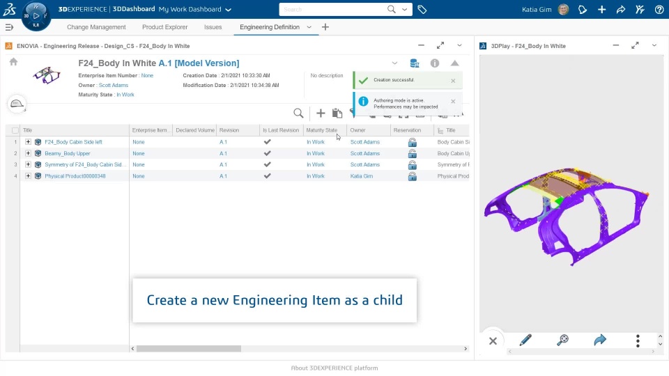

Index mode is turned ON:
  • This is the default mode
  • Indicates that the current content is displayed in index mode. Data is loaded from Index service, hence performance is good, however, the content may not be up to date.
  • It is automatically switched to Authoring mode following an authoring operation (such as add content to a bookmark, create new class, classify content etc.)
  • You can switch between authoring mode and index mode.
Authoring mode is turned ON
  • Indicates that the current content is displayed in authoring mode. Data is loaded from DB, hence the performance may not be as expected. The latest and exact content is displayed.
  • The authoring mode switches to index mode after 3 minutes since your last update
Index mode is turned OFF.
  • You cannot switch between the authoring and index modes
  • The system switches from Authoring mode and Index mode as required to tenable you to work with ‘Flattened View’ or the ‘Advanced Filter’.
When you mouse over the icon, a tool-tip displays the date and the mode of the last refresh
