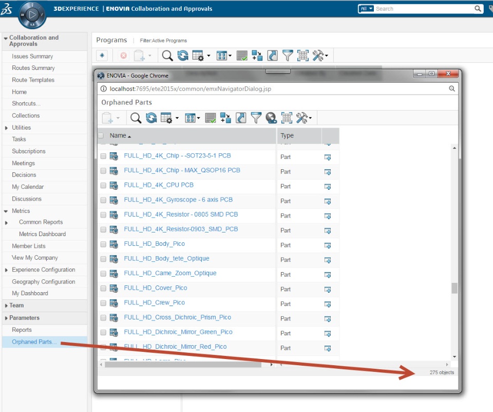

We have a simple command to query and fish out the orphaned parts that satisfy the conditions mentioned in the beginning.  When this code is implemented, the users can get the command as shown in the home screen, and, upon invoking this, the Orphaned Parts are displayed as shown.
