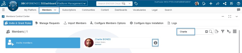

To do so, access the "Platform Administration" dashboard, and then select the "Members" tab. Proceed to search for the respective user. Select the information of the user.

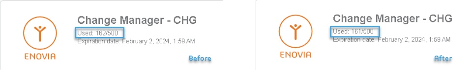

Hover your mouse over the "calendar" icon to find out when the license was assigned to the user. With this information, you are able to determine if 30 days have passed. If that's the case, you can safely un-assign the license from the user.
Prioritize the selectable licenses first, as some may be grayed out due to being prerequisites or being locked (30 days rule). It is recommended to handle these prerequisite licenses at the end of the process.

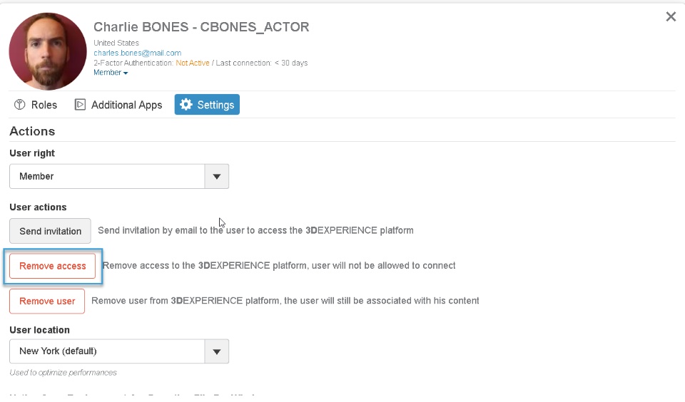

Once all the selectable licenses and the prerequisite licenses have been removed, you can  then remove the user access to the platform .
Removing the access to the 3DEXPERIENCE platform, prevents the user to connect to the platform. This action is reversible. If the user is back, you can give them the access back . If you want to remove completely the user from the platform, then use “Remove User” option.
