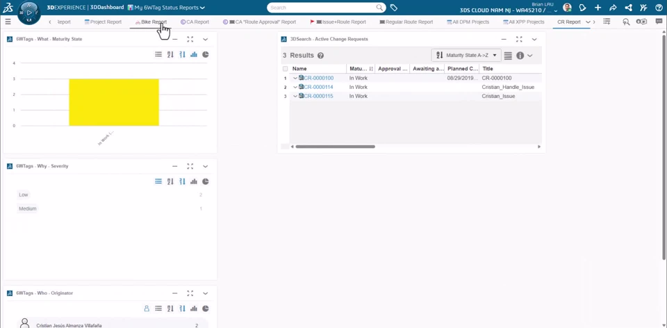

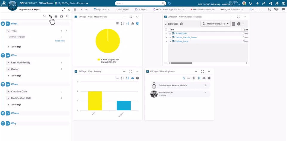

1️⃣Collab Tasks app + 🏷️6WTag widgets
  • Use Case:  Individual users can setup this dashboard to easily filter their own tasks in 3DEXPERIENCE platform.
0'26"

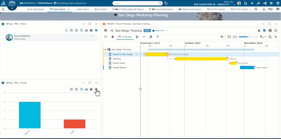

2️⃣XPP Project Planner app + 🏷️6WTag "Owner" & "Priority" widgets
  • Use Case:  Project team managers can setup this dashboard to easily visualize and filter their project tasks. Imagine adding custom attributes to Tasks, so that you can 🎨colorize or filter them quickly with 6WTag widgets.
0'37"

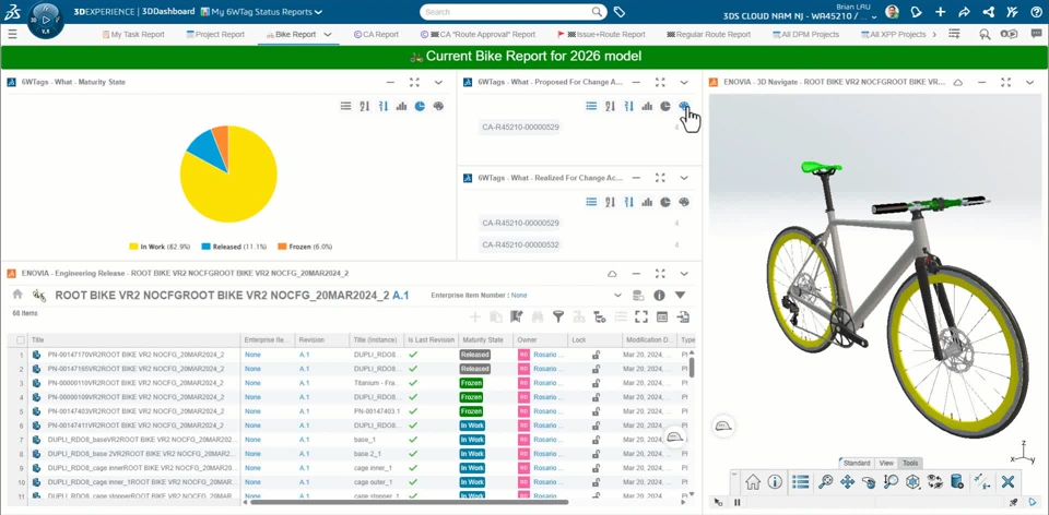

3️⃣XEN Engineering Release app + 🏷️6WTag "Maturity" & "CA Proposed Changes" widgets
  • Use Case:  Design team managers can setup this dashboard to filter easily on their 3D designs. Imagine adding custom attributes to Engineering Items, or classifications, so that you can filter them quickly with 6WTag widgets.
0'32"

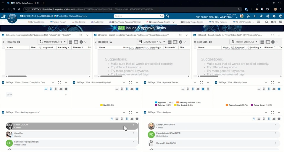

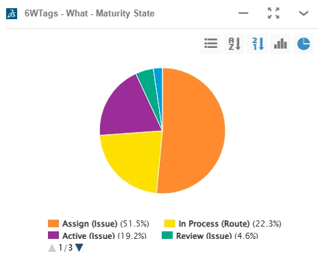

6️⃣📌Pinned "Issues" & "Issue Routes" 🔍search results + 🏷️6WTag "Planned Completion Date", "Escalation Required", "Approval Status", and "Awaiting approval of" widgets
  • Use Case:  Issue Managers can setup this dashboard to focus only on the Issues, Issue Approval Routes, and Issue Tasks. See the real-time Issues, and make key decisions from one dashboard.
0'57"
⚠️Notice the 6WTags can control multiple types (Issue & Route) across all or only selected widgets. (Not shown in video)
📌Pinned Search Results
  • type:Issue NOT "Closed" NOT "Create“  //Show all active Issues
  • type:Route "In Process" "Issue Management"  //Show active approval Routes for Issues
  • type:"Inbox Task" NOT "Complete" AND "Issue Management"  //Show active approval Tasks for Issues

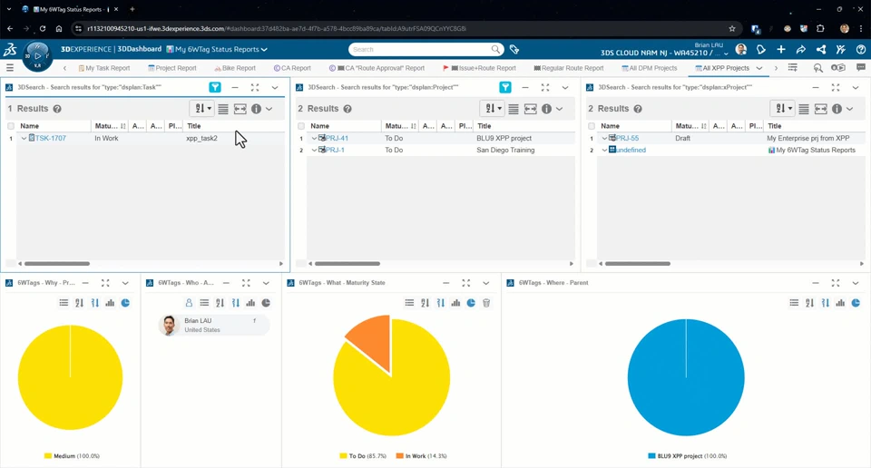

8️⃣📌Pinned "XPP Projects and Tasks" 🔍search results + 🏷️6WTag "Priority" and "Maturity State" widgets
  • Use Case:  Project Managers or anyone can setup this dashboard to focus on all XPP Projects and Project Tasks
  • ⚠️Notice the 6WTags can control multiple pinned search result widgets at once, or only selected widgets independently. Select the widget to highlight in blue, then select the 6WTag.
0'43"

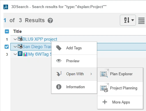

Non-XPP users can open projects into the free, Plan Explorer app
📌Pinned Search Results. XPP follows the newer RDF data model.
  • type:"dsplan:Project"  //XPP Team Project
  • type:"dsplan:xProject"  //XPP Enterprise Project
  • type:"dsplan:Task“  //XPP Task

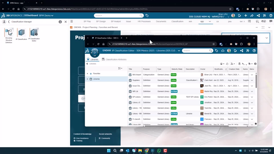

🪄1️⃣Open apps in Full screen in New Tab - 25x FD01 preference
1'42"

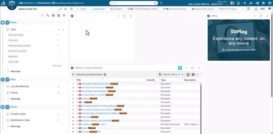

🪄2️⃣📌Pin Search Results to Dashboard
1'10"
🪄3️⃣📌Pin Advanced Search Results & 3DPlay to Dashboard
1'18"
🪄4️⃣Custom Search Result Columns
1'37"

🪄5️⃣📌Pin 6WTag as Widget to Dashboard - 23x FD03 drag & drop
0'52" - Works On-Prem and Cloud

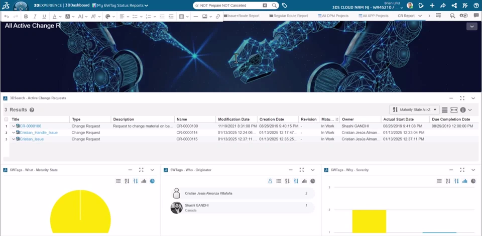

🪄7️⃣Dashboard - Text Box
0'37"
🪄8️⃣Dashboard - Options
Consider sharing with others, managing members, and setting this dashboard as your favorite or default at startup. Make it work for you and your company! It's easy and powerful!
