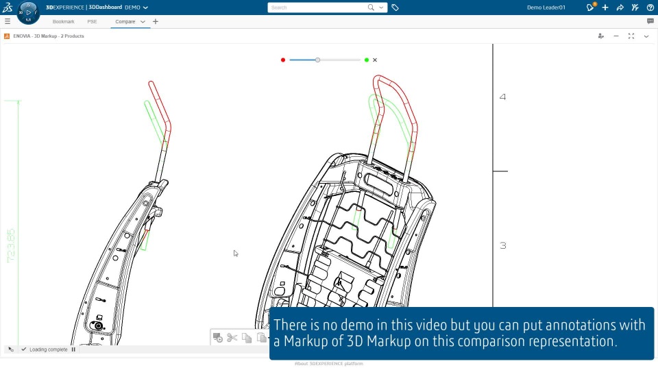

You can use "2D Compare" in the 3D Markup widget which is available in Collaborative Industry Innovator(CSV), not Compare widget. Some people may assume 3D Markup is only for 3D but the recent 3D Markup can load drawings, schematics or the other formats of data.
How does it behave?
You can see drawings comparison for CATIA V5 and SOLIDWORKS drawings in the video.
