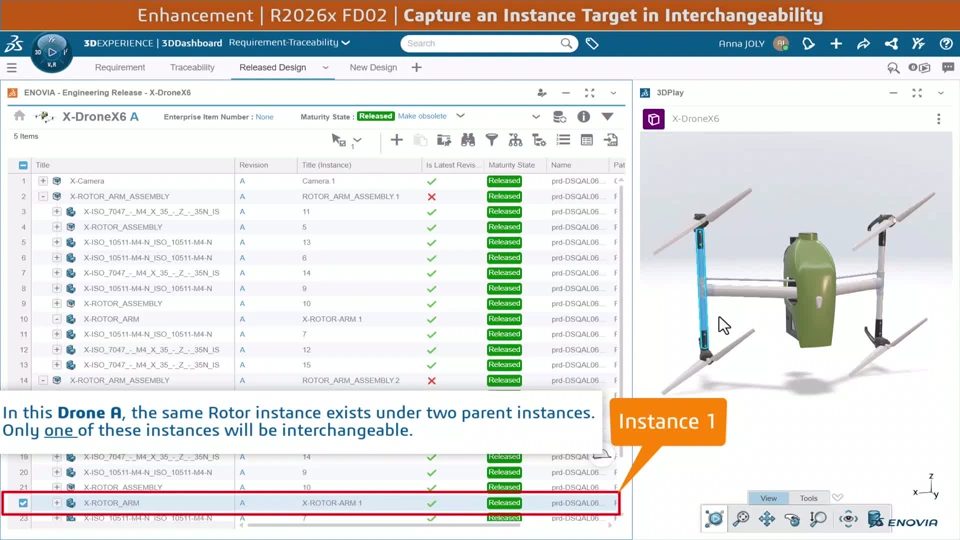

The following video illustrates this concept:
