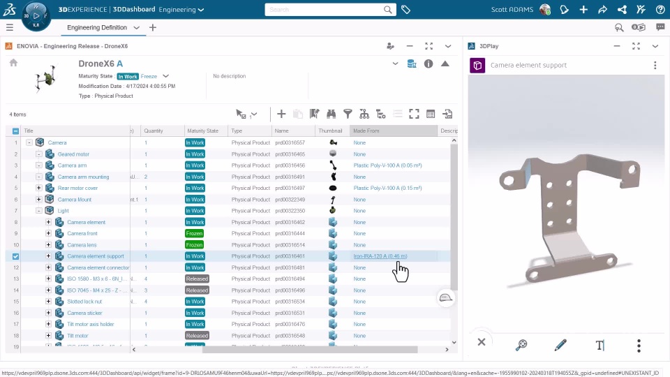

In ENOVIA, you create Raw Materials, using the role “Specification Manager (XSR)”.
The engineering uses this definition to describe the raw material that the Engineering Item is Made From.
Note that this definition is only relevant on parts and not assemblies, as assemblies do not have a single raw material.
Total required raw material calculation
In the Engineering Release widget, you can calculate the total raw material that is required for the complete product, using the view “Product Make From”. This view provides the list of all raw materials that the products in this assembly are made from.
This is useful for procurement/sourcing engineers who need to have an idea on the required total quantity for each raw material that is required for the manufacturing process of the assembly.
