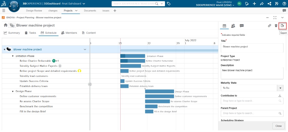

How to export a project
To export a project, use the ‘Export’ command, available in the Project Properties panel:
The exported file can be saved in a CSV format. The file name consists of the project name and the export date:

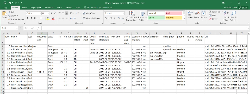

This is how the exported CSV file looks like:

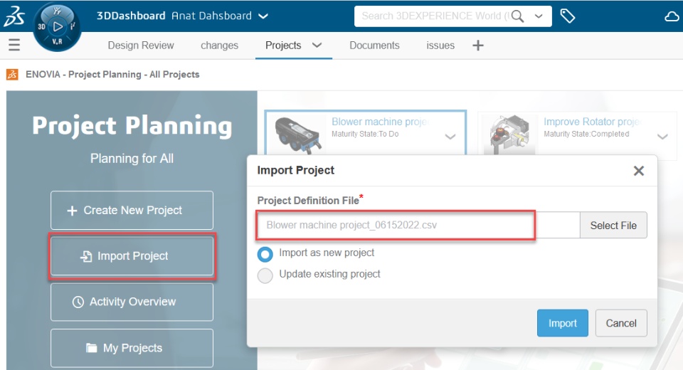

How to import a project
To import a project available in a CSV format:
  • Select the ‘Import Project’ in the Project Planning Home Page
  • Browse and select the CSV file
  • Select ‘ Import as a new project’ if you want to create a new project
  • Select ‘Update existing project’ if you did offline modifications in the CSV file and you want to update the existing project.
CSV File Syntax
The bellow table contains some tips and important information about the import CSV file:
 Column name
Required/
Optional for import?
Relevant at Creation / Update
Tips & Notes
Level
Required
Represents the tree structure of the project.
Must be the first column in the table, beside this, the sequencing of the columns does not matter
The value for the root project must be 0 or empty and the root project must appear in first line.
Name
Required
Free text used as the project element's Title
Type
Required
The first line must be the root project
Dependencies
Optional
Only at creation
Constraints can only be set between Tasks and Milestones, not Projects.
State
Optional
‘Open’ state will be set by default in case of empty or incorrect value
Optional
An integer indicating the percentage of completion of a Task.
0% will be set by default in case of empty or incorrect value
Duration
Required
Required for tasks. Not required for Milestones
Duration Offset
Optional
The duration offset value should be less than or equal to the duration value
Fixed Start
Optional
Different behavior
A TRUE value sets the date as fixed.
A FALSE value sets the date to not fixed
An empty value on create sets the date to not fixed.
An empty value on update does not change whether a date is fixed or not.
Actual Start Date
Optional
Some date syntax is potentially confusing; therefore, it is recommended to use the ISO date standard.
Estimated Start Date
Required
Fixed End
Optional
Different behavior
Same as Fixed Start
Actual End Date
Optional
Same as Actual Start date
Estimated End Date
Required
Owner
Optional
The login of the person who owns the element.
Assignees
Optional
Only at creation
Only persons, who have launched the ‘Project Planning’ app at least once, or member of at least one project, or assigned to at least one task, can be assigned through import.
Description
Optional
Free text used as the project element's Description
Priority
Optional
‘Medium’ priority will be set by default in case of empty or incorrect value
URI
Optional
Only at update
Used to identify the corresponding object when updating.
Do not fill in this column manually
External Id
Optional
Only at update
The external Id column is used for importing projects from an external system.
External System
Optional
It is highly recommended always to have an External System value when you have an External Id.
All objects from the same system should have the same string in that column.

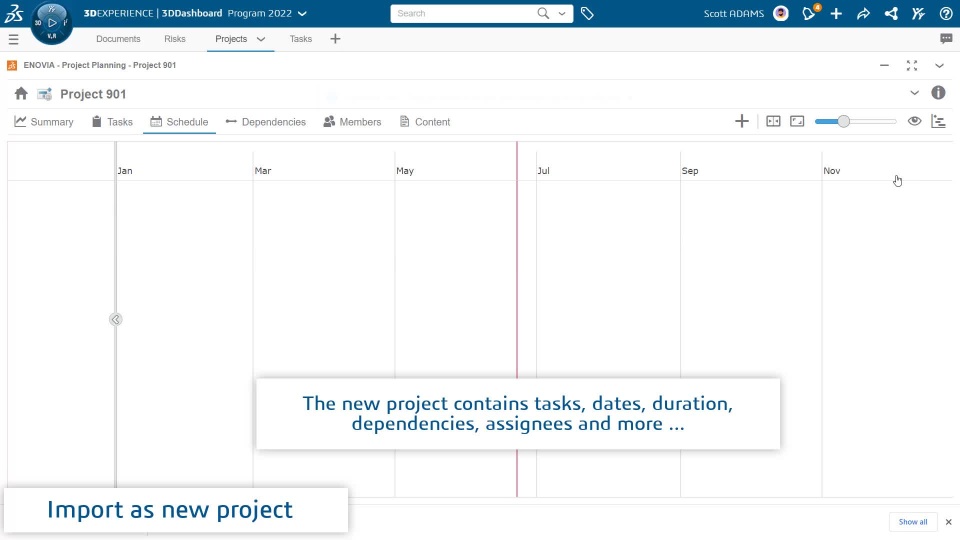

The following video illustrates how to work with export / import project :
