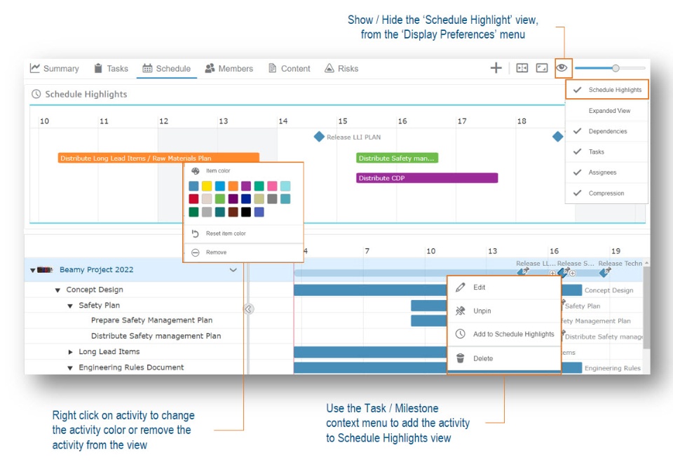

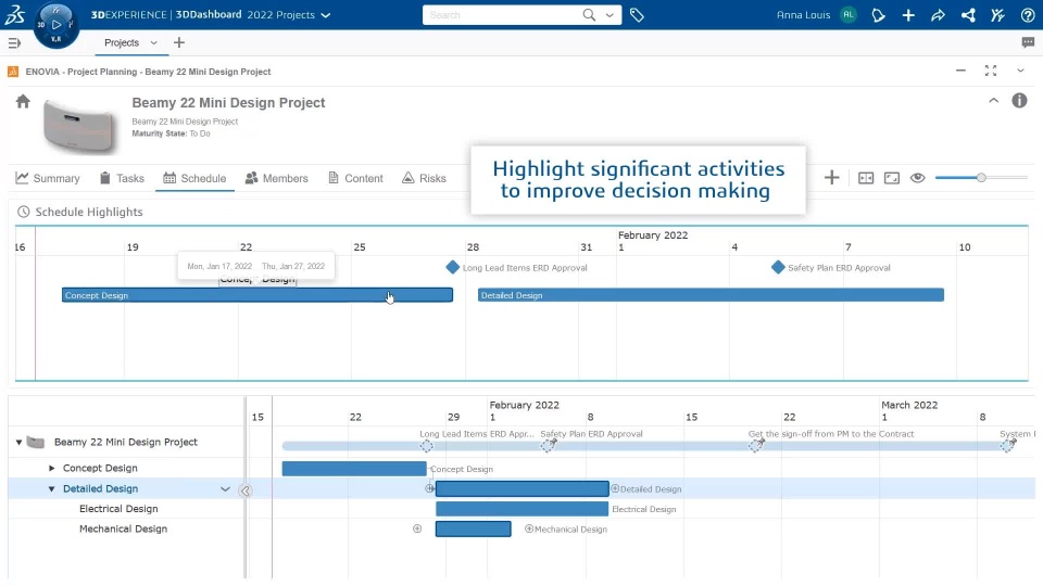

Schedule Highlights
The ‘Schedule Highlights’, allows Project Managers to build a summary view of the project, by adding and highlighting the key Tasks and Milestones which represent best the project schedule.
The ‘Schedule Highlights’ view is hidden by default, and can be displayed in Schedule view either by adding activities to it, or by opening it from the application using the ‘Display Preferences’ menu.
You can add activities to the ‘Schedule Highlights’ using the right mouse menu of the task or milestone. Then you can apply colors to the highlighted tasks and milestones in the ‘Schedule Highlights’.

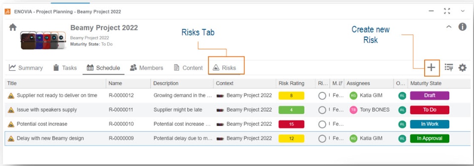

Risks Management
You can create, manage and track risks associated with the Enterprise Project.
Note: You need to have Project Manager (DPM) or Risk Manager (RSK) role assigned to you to work with risks in Project Planning application.
