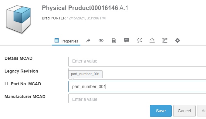

Find a Product and set the target mapped attribute value.

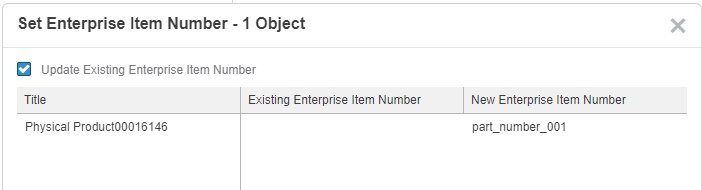

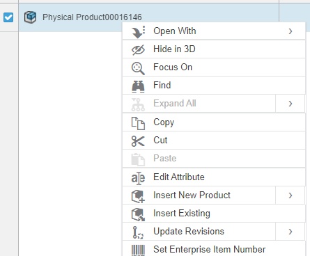

Select the Set Enterprise Item Number on the Product and you will see the mapped attribute as the New EIN.  Select the checkbox to Update Existing Enterprise Item Number and then Set.  The Enterprise Item Number is now set on the Product.
