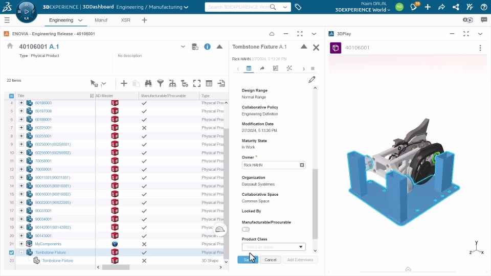

ENOVIA support of ‘Not in BOM’:
In the "Engineering Release" application, you have the capability to determine whether an Engineering Item is suitable for manufacturing or procurement by utilizing the Boolean attribute "Manufacturable/Procurable." Should the Engineering Item be unsuitable for either manufacturing or procurement, you can simply toggle the value of this attribute to "False."

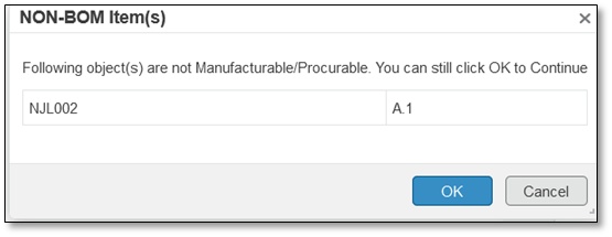

Important Note:
Upon creation of the manufacturing item (within DELMIA applications) for such an Engineering Item, you will receive a prompt with the following message:

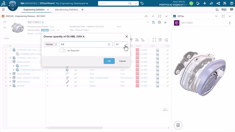

In the "Engineering Release" app, you have the capability to precisely specify the consumption of raw materials necessary for product production. This process involves:
  • Selecting an existing raw material (*).
  • Defining the exact quantity required along with its unit of measure using the "Existing Raw Material" command.
    • If the quantity is indeterminate at this stage, you can opt for "As-required.
The manufacturing definition within DELMIA apps builds upon the engineering phase, empowering users to adjust the quantities previously set during the engineering definition phase to ensure accurate production planning and execution
