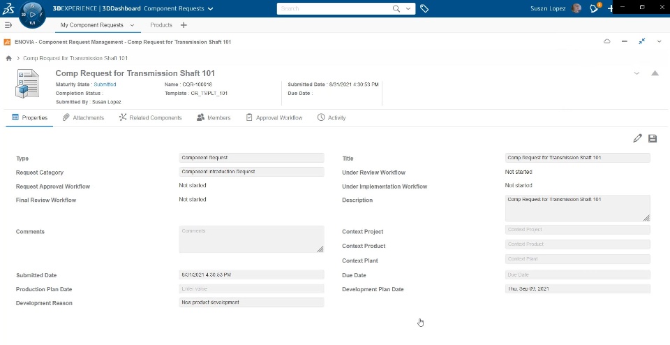

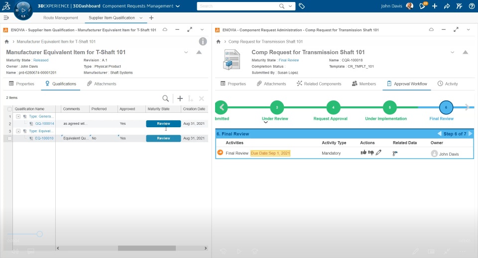

When a component request is submitted, it is created against a specific Engineering Item(s) considered as “Input Item” in the request. Further, the component engineer generates the Manufacturer Equivalent Item (MEI) and provides it as an “Answer Item” in the request that will be the proposed item to be sourced from the manufacturer. The MEI represents the component engineering specifications as provided by the manufacturer.
The Manufacturer Part Number, MPN, is also added to the request in order to ensure accurate definition.
Note:
  1. The “MPN” may not be unique across manufacturers.
  2. The MEI identification in the 3DEXPERIENCE platform is the combination of “MPN” and the “Manufacturer” ID. For example:

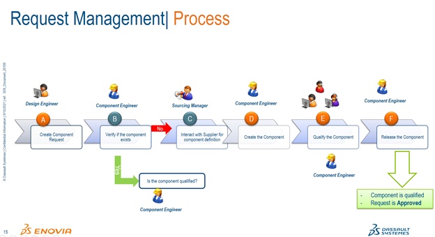

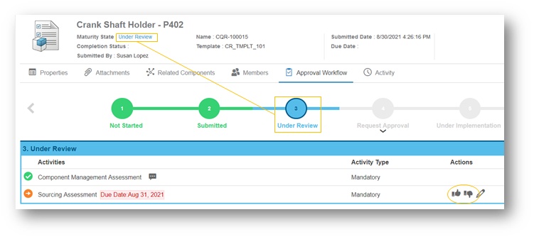

The complete approval process is governed by a graphical workflow that contains all the steps involved in each state of the component request. These steps are instantiated from the route templates that are defined by the component engineer, and that take into account the various component categories in the organization and their different approval process:
At the end of this process, the Manufacturer Equivalent Item (MEI) is qualified and the request is approved.
