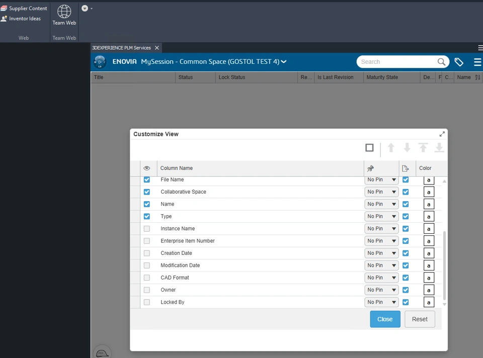

We are currently integrating 3DEXPERIENCE for one of our customers and have come across a limitation with the Inventor PowerBy functionality.
In the MySession app, the PowerBy view only allows us to display the default attributes as columns. It does not seem to be possible to add custom columns based on custom attributes. (Left image bellow)

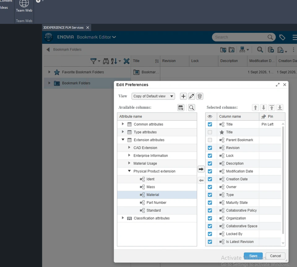

However, when accessing Bookmarks through PowerBy, there is an option to customize the view and add custom columns, including custom attributes. (Right image bellow)
Would it be possible to provide the same functionality in the MySession PowerBy view?
Having the ability to add custom columns and display relevant custom attributes directly in MySession would be very useful for engineers, as it would allow them to see the necessary information without having to navigate to another app.
