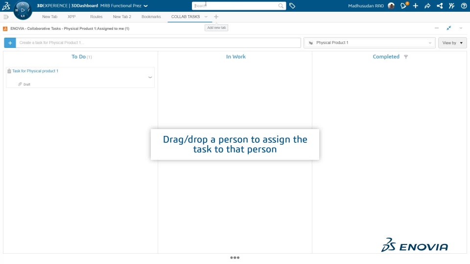

Third Enhancement: Assign task to a person by drag and drop
Search for a Person, select the individual and drag and drop them onto the task. It will automatically assign the task to that person. Again, this very nice enhancement that reduces many clicks.
