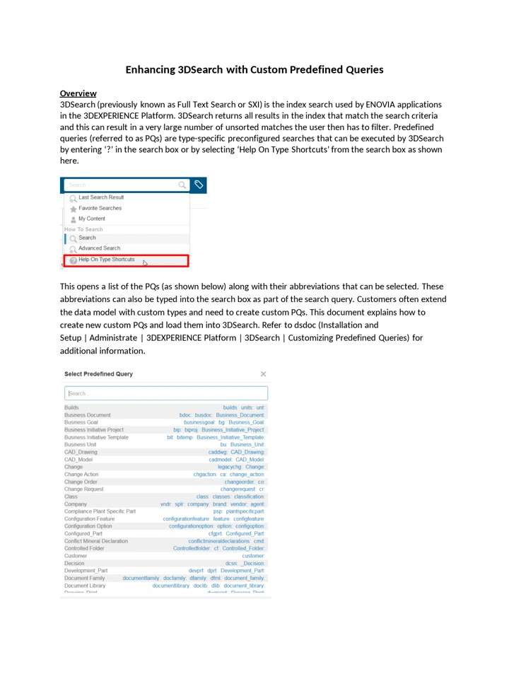

Are you taking full advantage of 3DSearch capabilities? 3DSearch returns all results in the index that match the search query. As such, it can return many unrelated items a user has to filter through. Predefined Queries allow users to quickly search for specific types which improves the overall search experience. You can further enhance and improve your 3DSearch experience by adding your own custom Predefined Queries. Refer to the attached document to see how!
