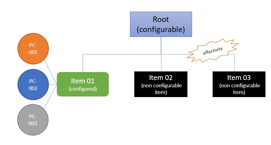

This is illustrated in the following example:
The root item has three Engineering Items:
  • Children Item 02 and Item 03:
    • Both are non-configurable items and can be linked, as-is, to the root with or without variant/option effectivity.
  • Child Item 01:
    • An engineering item that is configured and can be resolved by applying one of the 3 product configurations: PC-001, PC-002, PC-003.

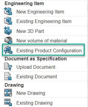

To add Item 01 to this definition, the user will have to select which product configuration should be used in order to resolve this item in the engineering definition. A new command is available from the “Engineering Release” widget to add “Existing Product Configuration”:
By selecting the relevant product configuration, the resolved Item 01 list will then be valid for the item in this specific root.

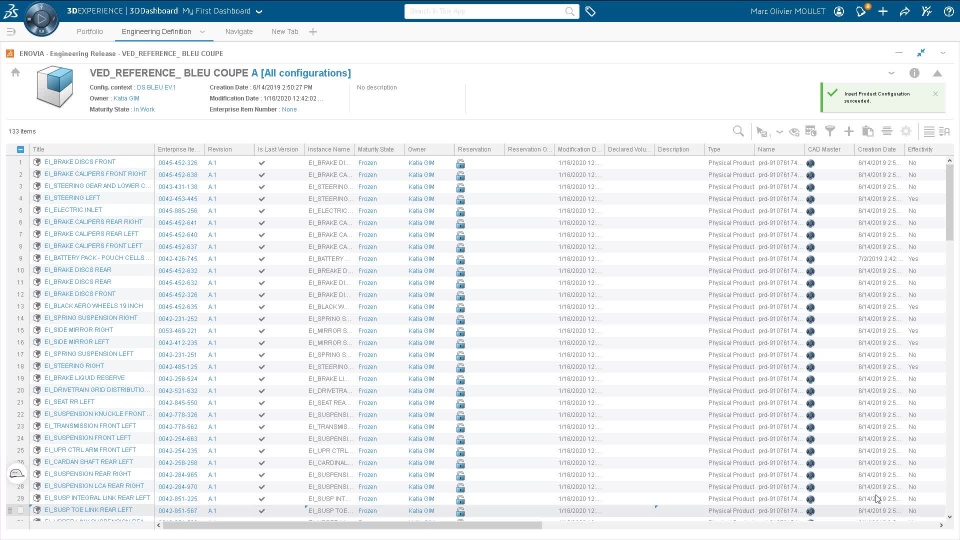

The attached video describes this process in more details
