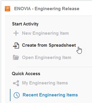

A new command, “Create from Spreadsheet,” is now available in the “Engineering Release” widget:
That enables the user to:

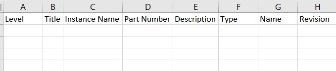

The basic template you can use should look like this:
Note:
If you download the template from the widget (using the corresponding command), you will get a spreadsheet template that contains more attributes than those shown in the image above. You can remove those that are not displayed in the above image, as you will not need them for the import (example: CAD Master, Modification date, Maturity state).
Attributes in the spreadsheet:
As you can see from this table, in order to reuse existing engineering items during the import, you must fill-in the following attributes in the spreadsheet: Level, type, name and revision.

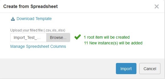

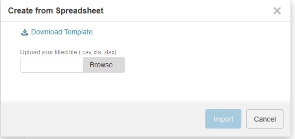

Using the command “Create from Spreadsheet”, you will be prompted to upload an existing file of the following format - CSV, XLS or XLSX:

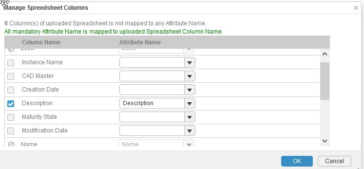

This file content will then be scanned and validated. If all values in the spreadsheet are correctly defined, then the following dialogue box will prompt the user to review the mapping:

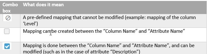

The combo boxes on the left side have the following meanings:
If the user does not wish to map certain columns from the spreadsheet, then they can simply deselect the combo box in the dialog box shown above for that mapping (this will remove the value in the combo box of “Attribute Name”).
Once the mapping is finalized, then the import will begin, after clicking on “Import”:

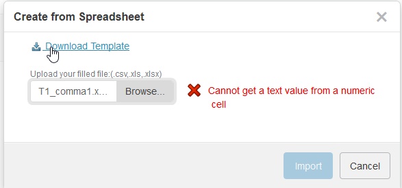

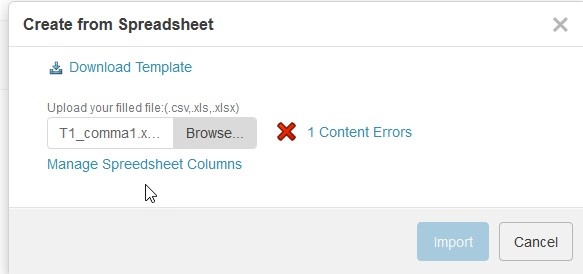

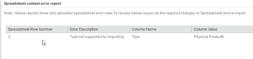

If there is an issue with the spreadsheet content, such as wrong column name or wrong cell value, then a hyperlinked error message will be displayed to the user to review the issue:
                                           (Column name-related error)
                                               (Content-related error)
Clicking on the error message, displays a detailed report showing more info related to the error and its location in the spreadsheet:

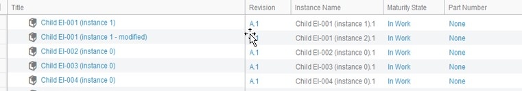

  3. Currently, the attribute “Instance Name” is not mapped to “Instance Title.” This leads to the creation of an instance with “Instance name” value same as “Title” with suffix .1, .2 etc…
This issue is slated to be resolved in 19x FD04.
